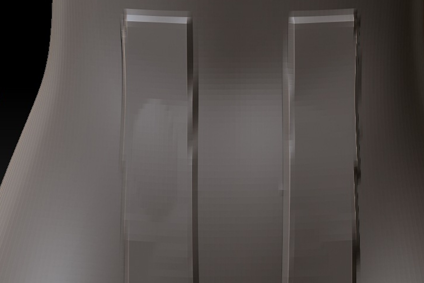

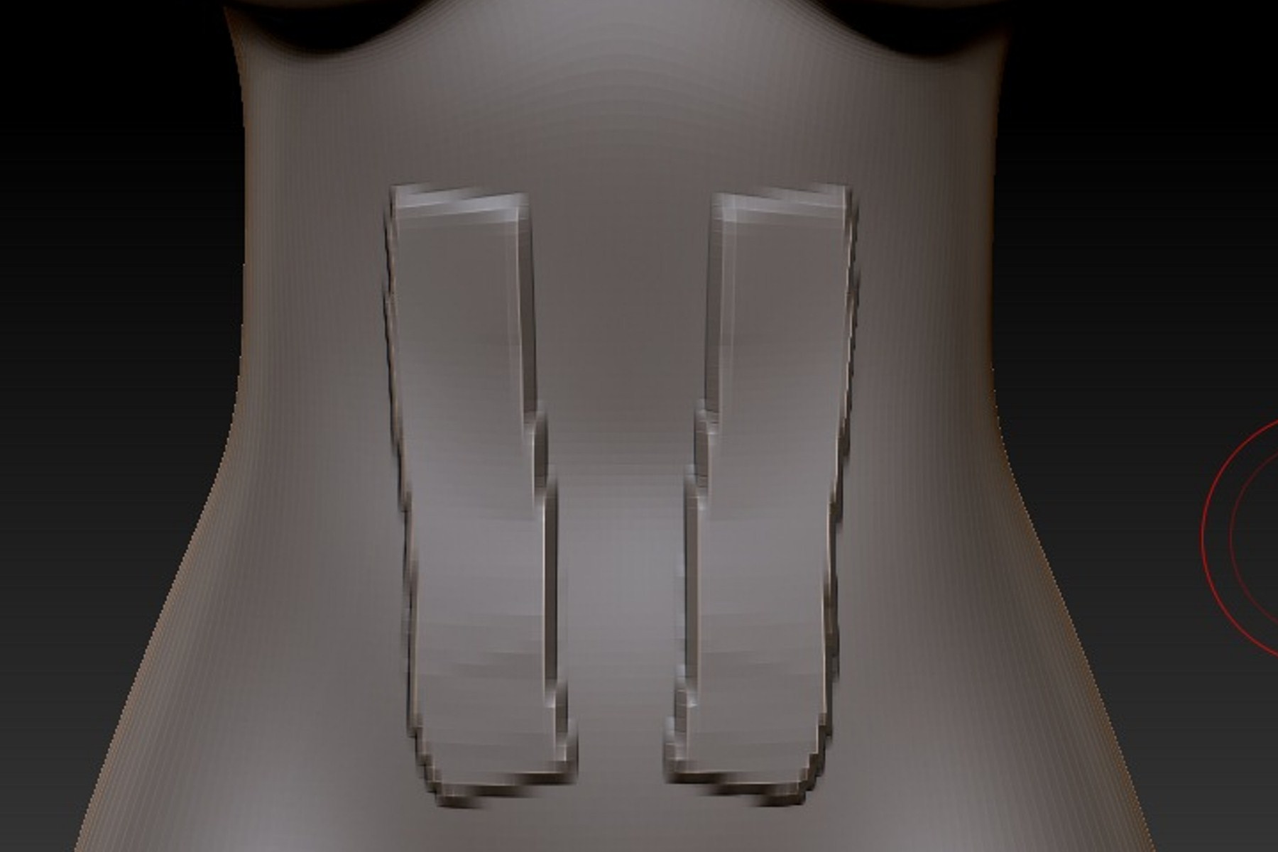

So I retopoed a mesh in topogun( modeled one half then created symmetrical other half ). Now the weird part is when I try to sculpt in zbrush from the right side the sym is off( first pic ). But if I sculpt from the left side the sym is fine( second pic ). I have done everything I know of in zbrush and as far as zbrush is concerned the sym is fine. Also the problem is only present in the stomach area. Any ideas?
Are the surface normals by chance flipped on one side? Are the two sides welded? Have you tried doing a smart resym deformation (at level 1 and then working your way up through the levels) just in case something is a little off somehow?
Thanks aurick, the smart resym worked, which is odd because it didn’t work before? Either way, problem solved thanks a bunch:D
