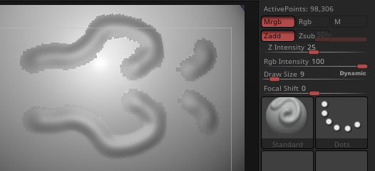

Are you painting materials and colors without noticing it? That is what it looks instead any deformation from any brush. Is the material button active or the Mrgb as in my screenshot?
No it’s the RGB button. That comes on when I switch to Nudge. If I switch it off I don’t get those lines…
Thanks!!!
