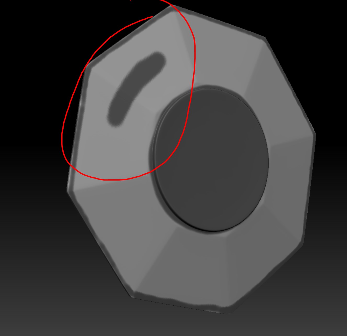

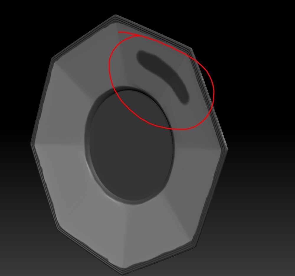

Hello, in this work, while making a mask, it does the same from the back. I just want to mask the front side. What is the solution to this?
Hi @Enes_Saka
You can use BackfaceMask in âBrush > Auto Maskingâ. If using it for masks, you have to hold down Ctrl when you enable it. However, BackfaceMask only works with Dots, DragRect and FreeHand strokes. For the rest of the strokes, you will have to hide the back side. This can be easily done with Polygroups. If you go to âTool > Polygroupsâ you can use âGroup Frontâ to group the camera view then just Ctrl+Shift+Click on that group to hide the back.
