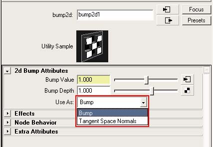

You input normal map simple as bump map! but you have to change from “bumpmap” to “tangentmap” in atribute editor
to Chovasie
where can i change it to tangent? i tried going to the attribite editor and cant find it… im really a newbie in this… i really want to make this work:cry:
Thanks for the help to both of you!
here!1 just swithc here…
