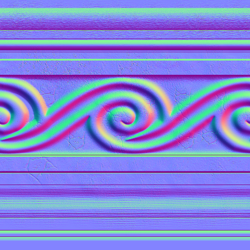

I’m talking about when i do a tileable canvas modeling. Where I apply the normalRGBMat to the zbrush document. So I would like to know if it’s default at Y postive or negative.
thanks

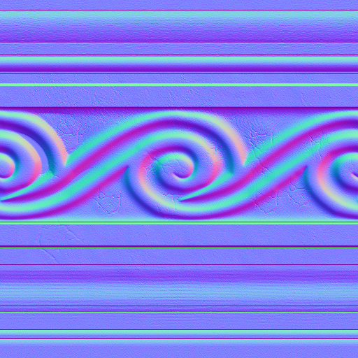

OK… I think I solved it. NormalRGB Mat make a Y negative normal map.
This is from the Nvidia filter with the setting of Y negative.
So My next question would be again is there way that I can tweak the setting within zbrush on the Normal RGb Mat… cuz I know each software packages have different normal map setting.
