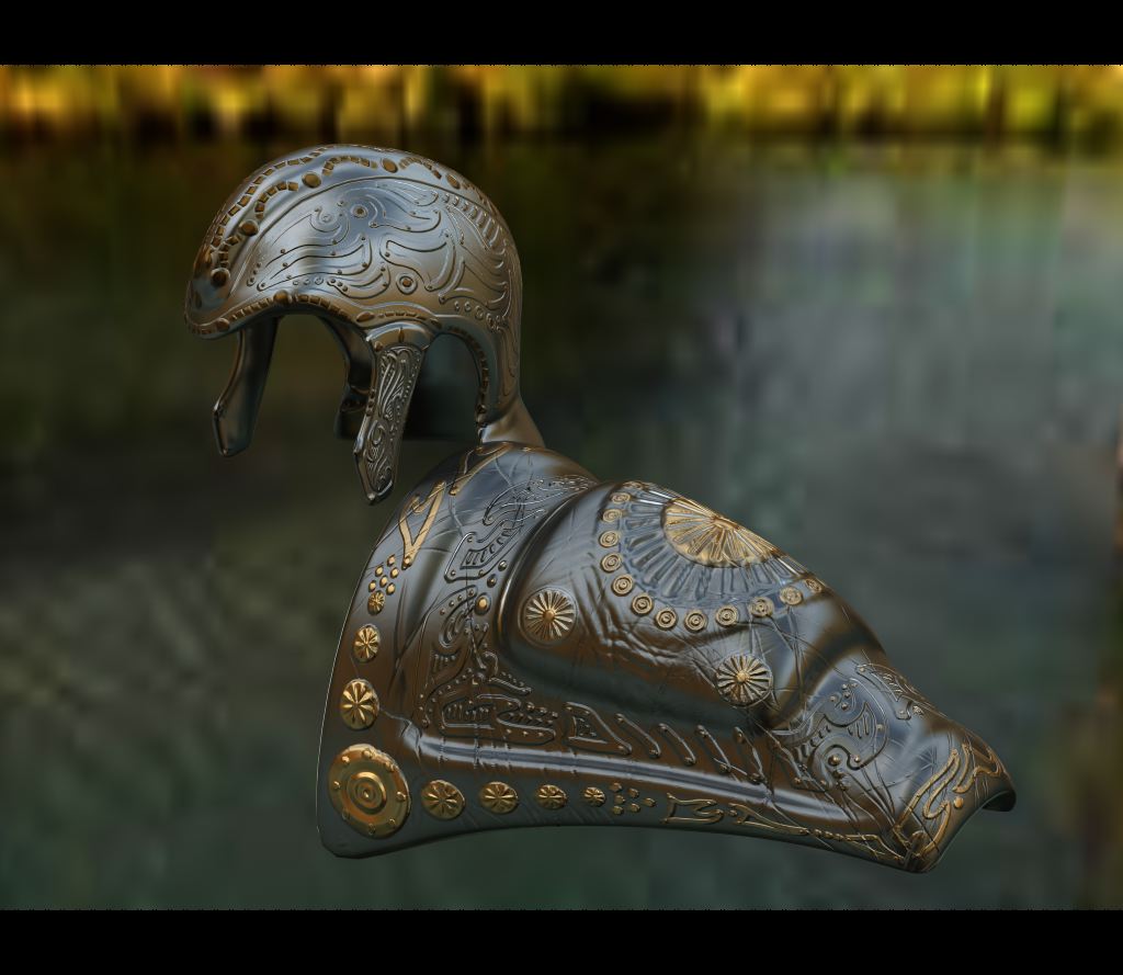

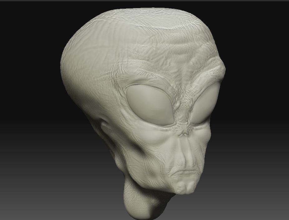

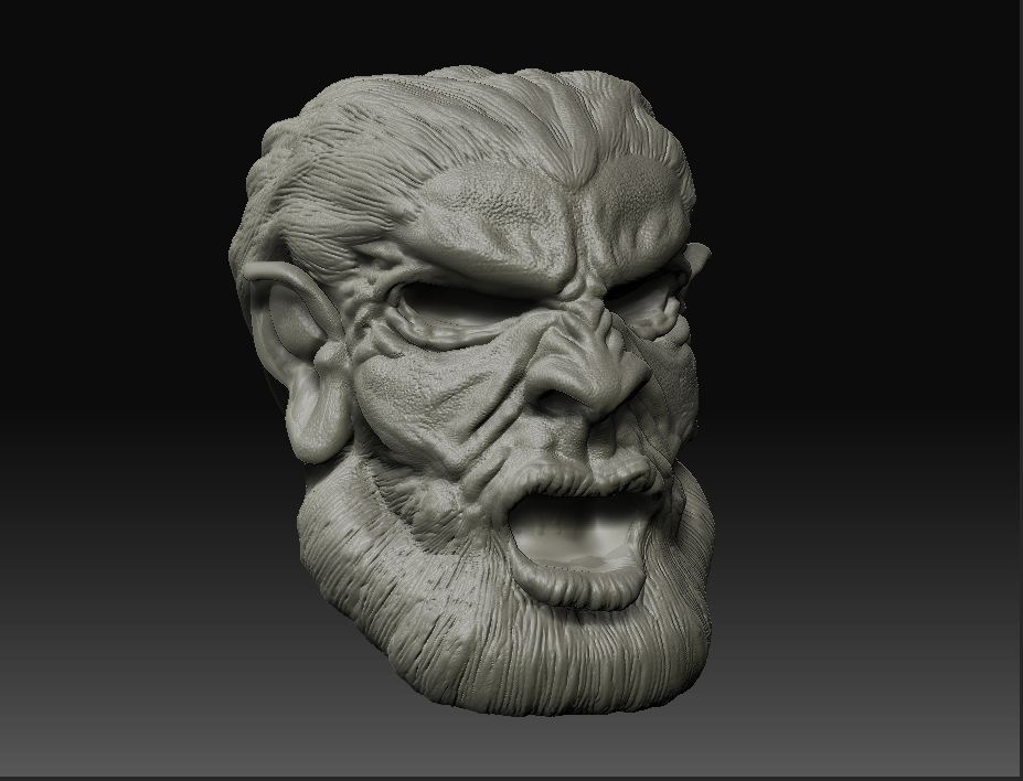

Finaly 3.1 has normal map generation!
Here are some guys I recently made. The timelapse are here.
( http://youtube.com/watch?v=JOmk8gD5FbY )
( http://youtube.com/watch?v=uTS-L-ReaI4 )
Please watch all my vids! and rate’em!
Thank you.
