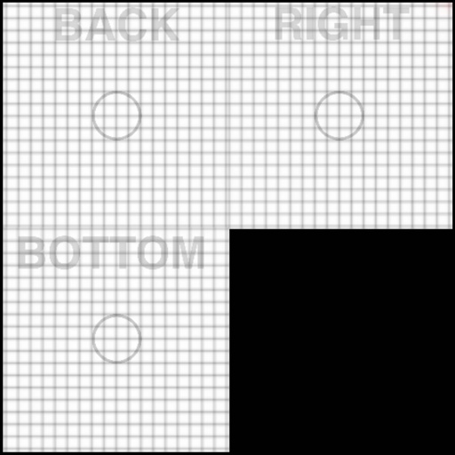

2. Go to “Tools > Texture Map” and clone the texture then, in the Texture menu at the top, export it for reference. If you want, you can just use the SBRef.psd file in your ZTools folder instead (recommended).
3. Create the shape in your 2D app to match the view on the texture. (must be black on white and not white on black like an alpha). Don’t just draw on top of the texture and use that. What you draw should be on a plain white background.

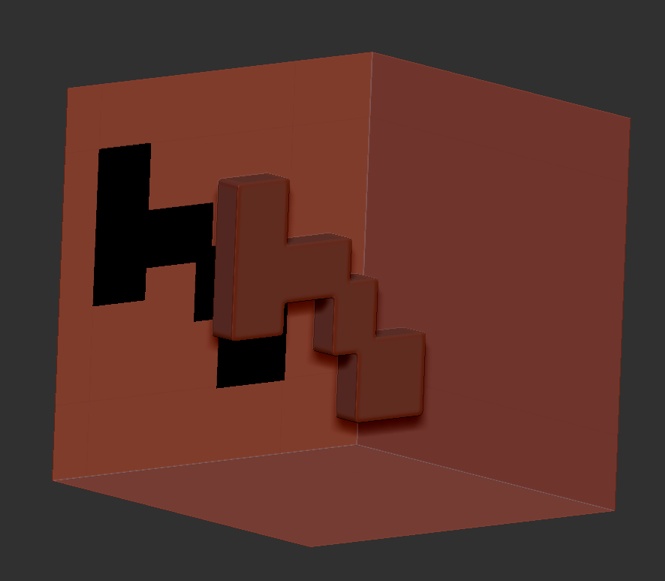

4. Import it back into the Texture palette then go to “Tool > Texture Map” and click “New Texture” then click icon to select it and apply to the ShadowBox.

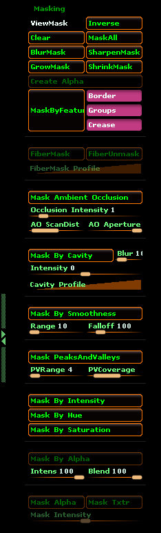

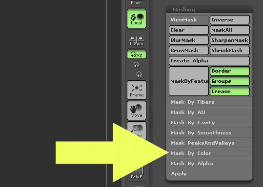

5. Go to “Tool > Masking > Mask by Color” and click “Mask by Intensity” button. Ctrl+click in ShadowBox to update.
6. If necessary, draw a rectangle on the side to increase the extrude.
Note: Works well for text.
STEP 2 from above
STEP 3 from above
STEP 5 from above

Thanks. :+1: That works a treat. I was somewhat confused with the line “mask by color” , however, “mask by intensity” was there :wink:

My UI differs from yours somehow. :wink:
