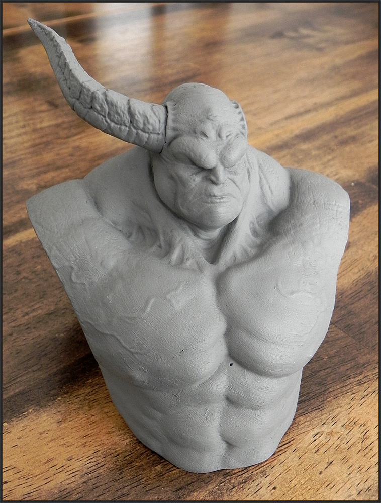

Here is the ZBrush Heavy Demon 3D Bust after being printed on the Form Labs 1 +. (100 microns, would have liked a higher resolution but the peel force at lower microns with this large of a print was causing print failures.) Now it is time to start cleaning this up and painting.
More to come! :slight_smile:

Was this a hollow print or solid? And do you see more print failures from hollow prints?
This model is hollowed out. There might be more print flute due to hollowing, if it is too thin that can be a problem for sur, especially if you if you leave it in the alcohol bath too long. I have also seen cracking during the uvs curing process. But if you don’t hollow out, you increase material cost and increase build times.
I would so more of the failures I have seen have been due to me trying to print as large as possible at 25 microns. The peel force on the larger prints at the highest resolution seems to be problematic.
The 25 microns seems to work better on smaller objects, but man is it pretty when it is done.
The other thing is you can’t see a lot of the detail that is there until you paint it flat grey, the surface is somewhat translucent, and this hides some of the detail.
Print orientation and support stutter attachment points is another interesting game you have to play to get your part printed.
Overall, the process is somewhat technical, beautiful, frustrating and amazing all at the same time. :slight_smile:

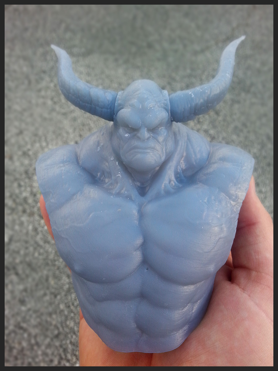

So here is the bust and one of the horns cleaned up a bit and a first pass at the paint job, Need to do some more sanding in areas an fill little holes. I have a drain hole on the top of the head that is rather large that needs to be filled as well. I was being lazy and painting this with some cheap spray paint, finally had enough and busted out the old airbrush and was able to get a much better coverage!
Now onto printing the base and the other horn, I am hoping this will be done by end of day today! :slight_smile:
The photo seems to pick up more imperfections than what is easy to see with the naked eye, unless you hold the thing really close to your face! :slight_smile:
Well, it took awhile to get the prints for the horn and base done. But here are the final results. I found out there was some sort of corruption with my base obj file and it caused some very odd lines and cracking on the base. I was able to glue it back together for the most part. But we are doing a whole other print of this thing so there will be 2 copies when all is said and done. I went back and fixed my base file and this will now need to be printed along with one new horn. But I am pretty happy with the results of my first full 3D print. Pretty exciting stuff!
Hope you enjoy! :slight_smile:

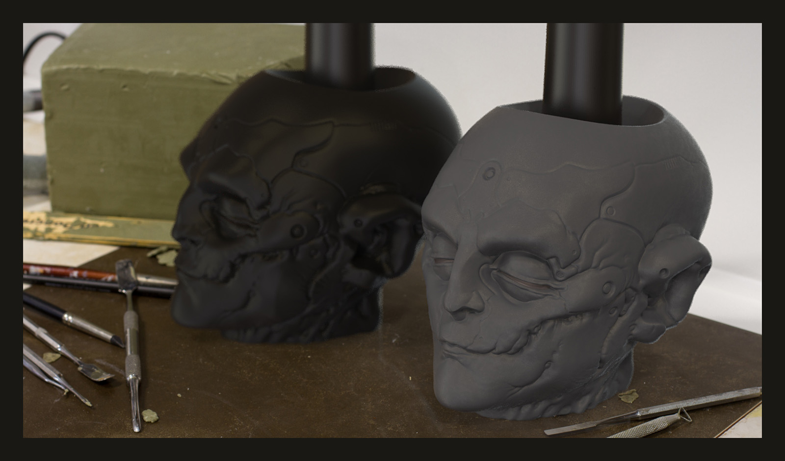

So this will be the next 3D print that I make. I already have the model prepped for print. I have already printed it, had a fail in an area, the middle fingers failed as well…but I think I understand why so I rebuilt those areas.
Hope to show the print very soon.
Here is what I plan to 3D print next. This will be a custom pen holder for a Wacom pen. Hope to get it printed up some time this Wednesday.
Peace, NickZ. :slight_smile:
