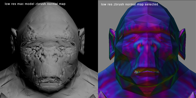

i have been having difficulties getting my normal maps to look good in max. as far as i can tell the normal maps zbrush is rendering are ok although i can see some bad things happening (operator error im sure).

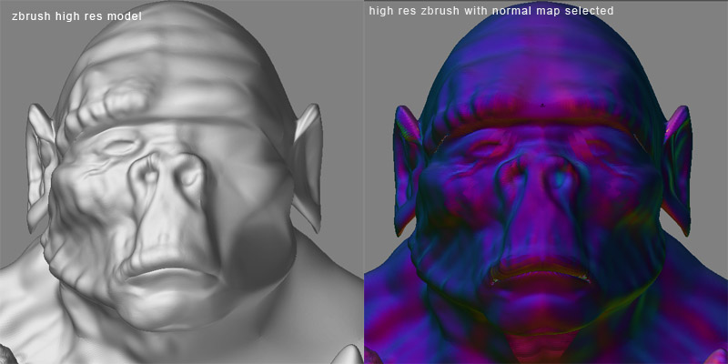

heres some pics of the high and low res model with the same normal maps being used. i cant figure out where all these lines and distortions are coming from in the low res max mesh with normal map applied.
any ideas are welcome…

hmm i tired those settings and it doesnt seem to make a difference. however im not using the mesh from zb just the normal map and then placing it onto the original mesh in max.

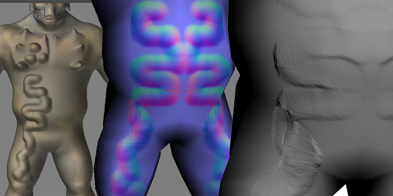

heres a pic of the normal map i created with the settings u provided.
any further insight would be greatly appreciated.

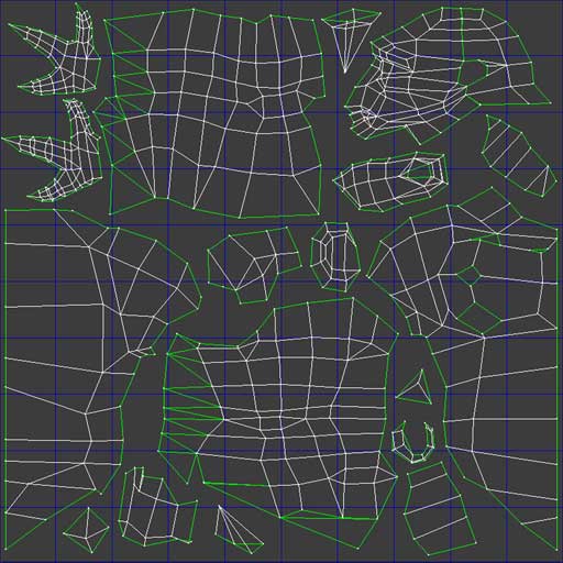

my uvw map.

Are you using mirrored UV’s too? DOesn’t ZBrush have issues with that?? If so delete half the head and try that.
i’ve had massive banding problems with morph targets in max…
u can’t use mirrored uv’s in zbrush, cause zbrush handles it like overlapps.
u have to paint only one half of your geo/model.:wink:
