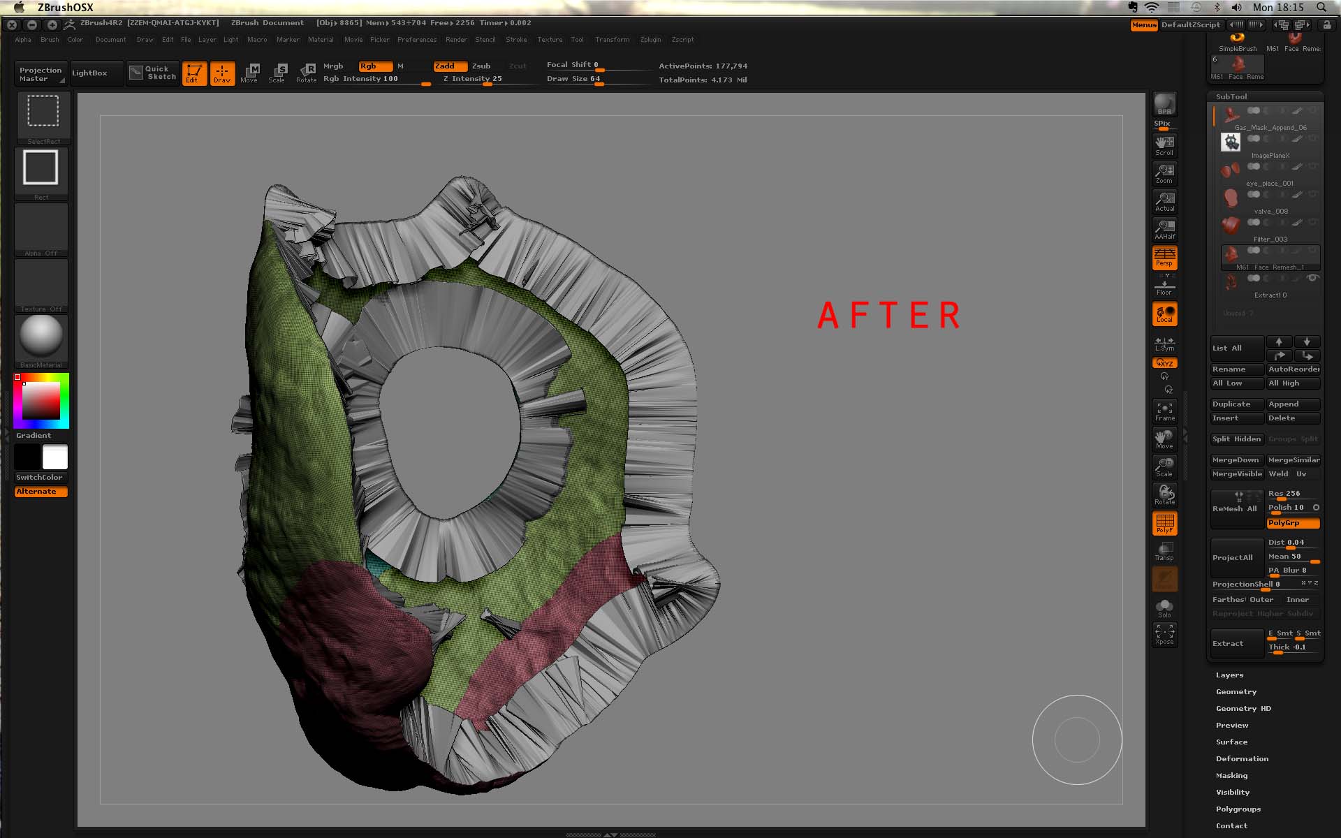

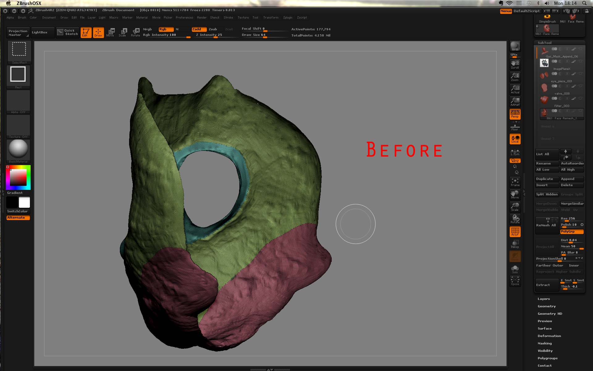

I’ve been following a tutorial on how to make a gas mask. This is the first time i have attempted anything in ZBrush so it is entirely conceivable that I will need to go back to the beginning. The gas mask is made from ZSpheres and has been re-meshed several times. I have painted polygroups on to it and then hidden the groups that I don’t want in the extraction. When I extract (edge Smoothness at 0, Surface Smoothness 0 and Thickness -0.1 - though i have attempted different combinations here) I get a really nasty and unexpected result. See before and after images.
Like I said - it is entirely possible that I will have to start again, but If I could understand what I have done wrong that would make me more confident when attempting it again.

I don’t know if I have a great answer for you, but it almost looks like it would be easier to retopologize the mask by appending a z sphere to your head than trying to mess with extraction. I have had the best luck using either no thickness (set to 0), or using a smaller deviation from 0 ( -.01 or .01). -.1 or higher has never resulted in a workable mesh for me. The edge smooth can probably be turned up a slight notch to reduce that jumbled mess at the edges, but with a high poly count, it might not help.
Holding shift and clicking “uncrease” might allow you to smooth some of those edges, but I really think retopology might be faster, just use the Append method rather than the Rigging method.
