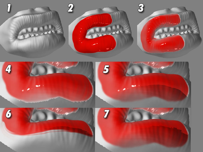

Maybe some pics will explain better ?
  1. Model loaded with sample area exposed.
  2. Inside PM, I painted a few strokes with red plastic.
  3. After exiting PM.
  4. Re-entered PM to touch up this section.
Now for example, I want to erase some of the red under the lip area.
  1. After painting with just material “M” as you suggested. Not working.
  2. In side PM, I used the smudge tool which it “almost” what I’m trying to do.
  3. After exiting PM. The smudged area REAPPEARS in the texture. :mad: :mad:
I don’t know what I could be doing wrong? It all seems easy enough.

PM shading was off and the base material was basic, the one ZBrush
uses right after initializing.
Section 6 is what I’d like to do, but erase the red, not smudge it off.
Which I could have dealt with if not for it looking like Section 7 when
I was done.
Section 5 is half way there. I could see the toy plastic was being
remove but the red was not.
