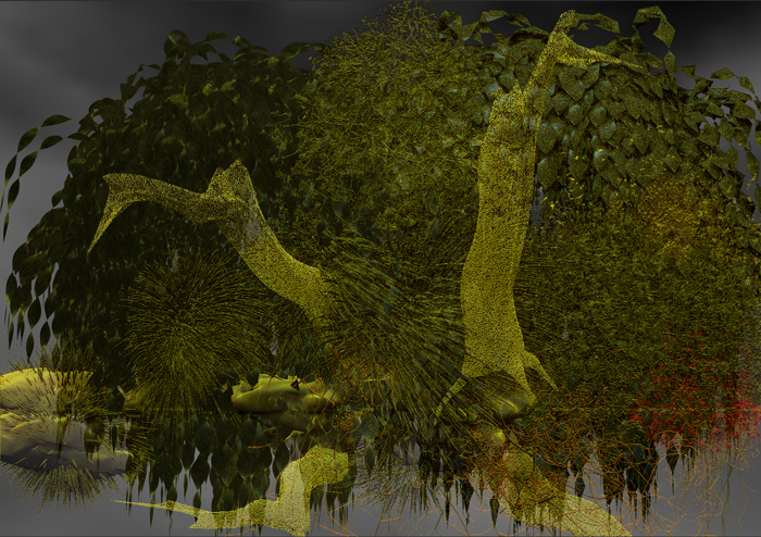

A little FiberMesh / LightCap study this morning…All merged as one tool with a BPR render applied, and then saved it within ZBRUSH as a 2.5 document using the method that Bonecradle wrote about and posted above.
MAR. 22, 2012

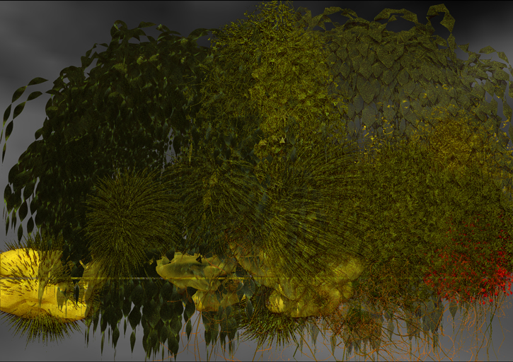

A little more experimenting on and with this piece this morning.
All ZBRUSH
Glenn

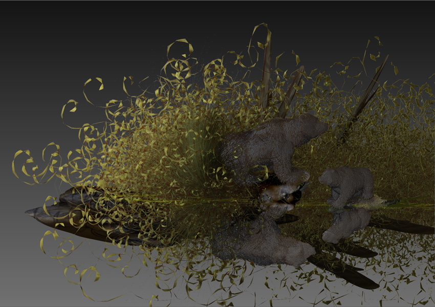

Some more experimenting with this piece this morning…FiberMesh / LightCap
All ZBRUSH

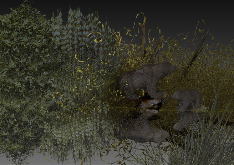

Start of another FiberMesh / LightCap experiment this evening.
All ZBRUSH
Glenn

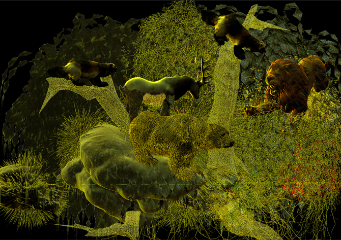

Just experimenting and trying to get out of these new features what is right for me and the kind of painting that I enjoy doing.

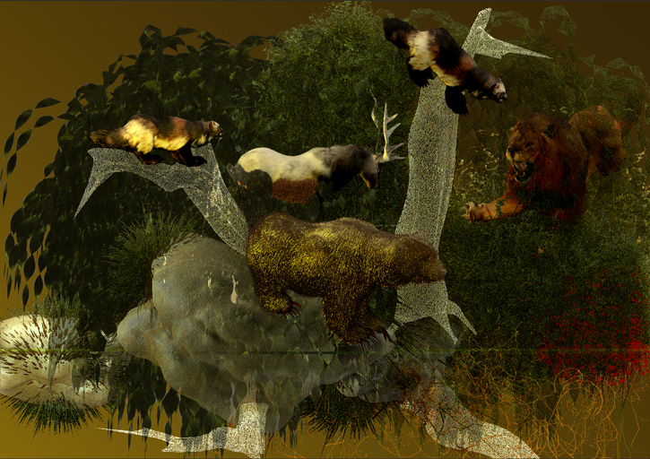

Took this piece into Corel Painter this morning…pressed soften in the effects feature of that program, and the undesired pixolated digital look went away…I have been wondering how that soften feature in Corel Painter would react with this new FiberMesh that does not have a BPR or Best render preview applied to it…Now I know…Works Great.and looks good even when inlarged…will make good printed posters ect…
Glenn
