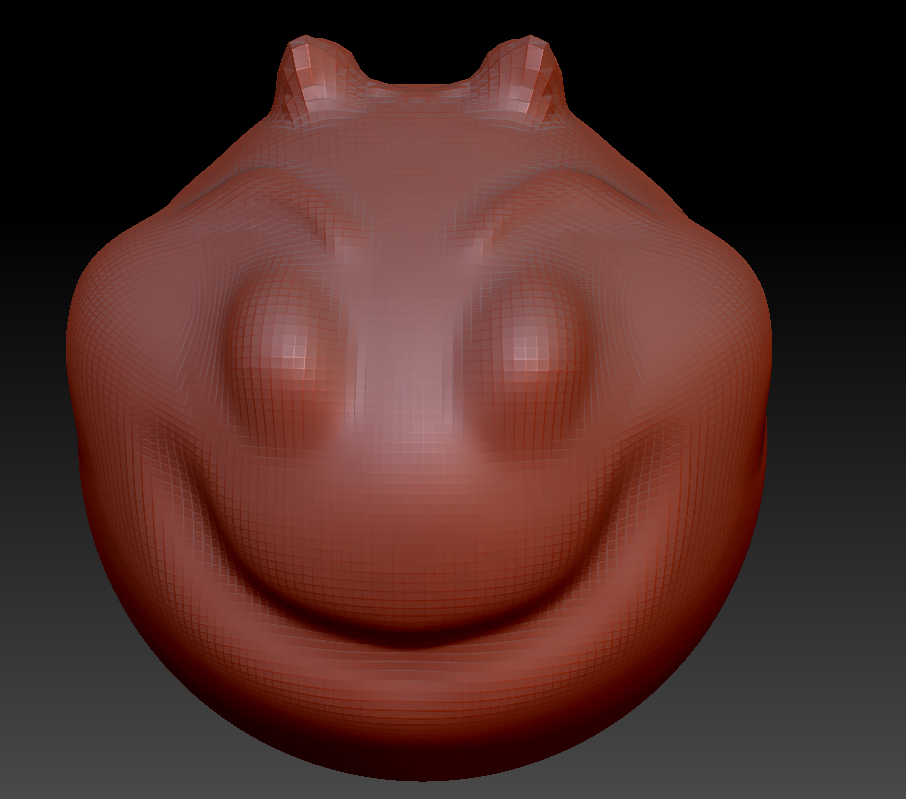

So I had a bit of a play, and I have noticed that the image I am seeing on my screen seems quite faceted, (as shown in the images below)
The smiley face, seems to almost have a quilted effect on it? It is just the standard tool sphere I was playing around with… (I think like 3 subdivisions) it is almost as if all the edges of the faces are highlighted and its quite distracting. Is this normal? or is there a setting somewhere that sorta smooths the edges so they aren’t quite so prominent?

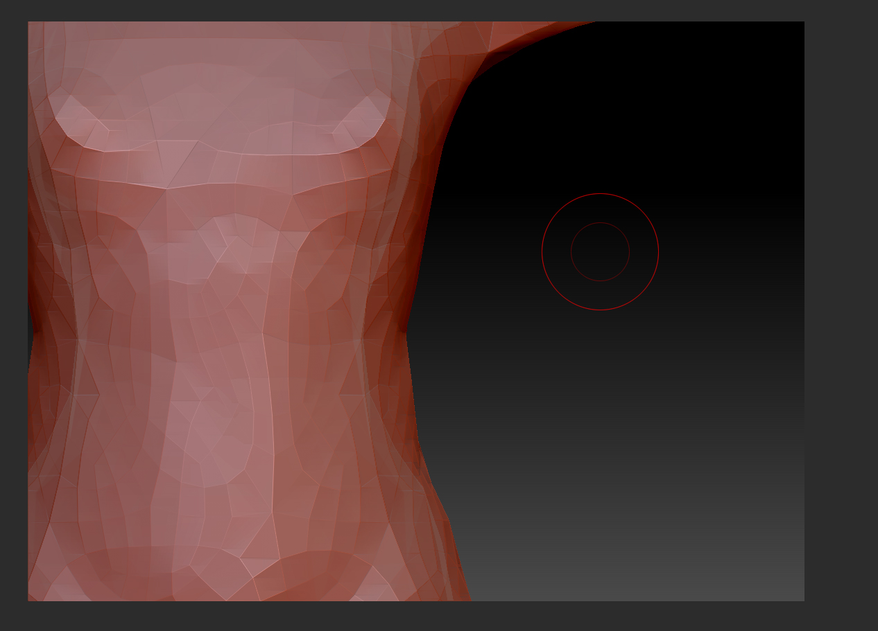

This second image only has I think 2 subdivision levels on it so obviously it is more faceted but, it takes about 8 subdivision levels for it to look smooth on my screen.

It’s standard. You can either
  • increase the geometry’s resolution as you have been
  • have BPR smooth them a bit when rendering (Render: Render Properties: Smooth Normals)
  • Turn off Transform: Quick 3D Edit and set your Tool: Display Properties: DSmooth to 1 (maybe bind this to a hotkey so you can toggle it quicker than bpr can render)

As a new user as well I was having this same issue and wondered if it was normal, particularly as the tutorial vids I was following did not seem to show the same level of chunkyness (technical term there :wink: )
It is because tools ( the ones I’ve used at least) don’t add geometry, just change what exists already. Ill be interested to see when I get back on to zbrush later if the Transform option change suggested by Cryrid adds geometry.
