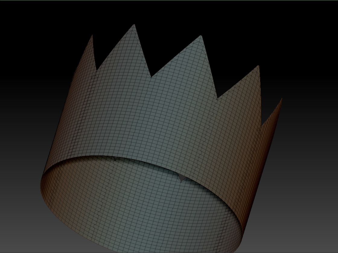

Hi !
Is there a way to get a new surface ( no thickness ) from an old surface? Here is my old surface that is made up of sliced parts and polygrouped together but the slices are still separate even after welding. . .
use extract and delete the extra faces that it generates. Not sure if that will weld everything though…
You may find that exporting and importing into a new tool will weld the points:
  1. Export the mesh as an OBJ.
  2. Select the polymesh star.
  3. In the Import sub-palette (towards the bottom of the Tool palette) turn on the Mrg option and set the Weld slder to its maximum.
  4. Import the OBJ.
