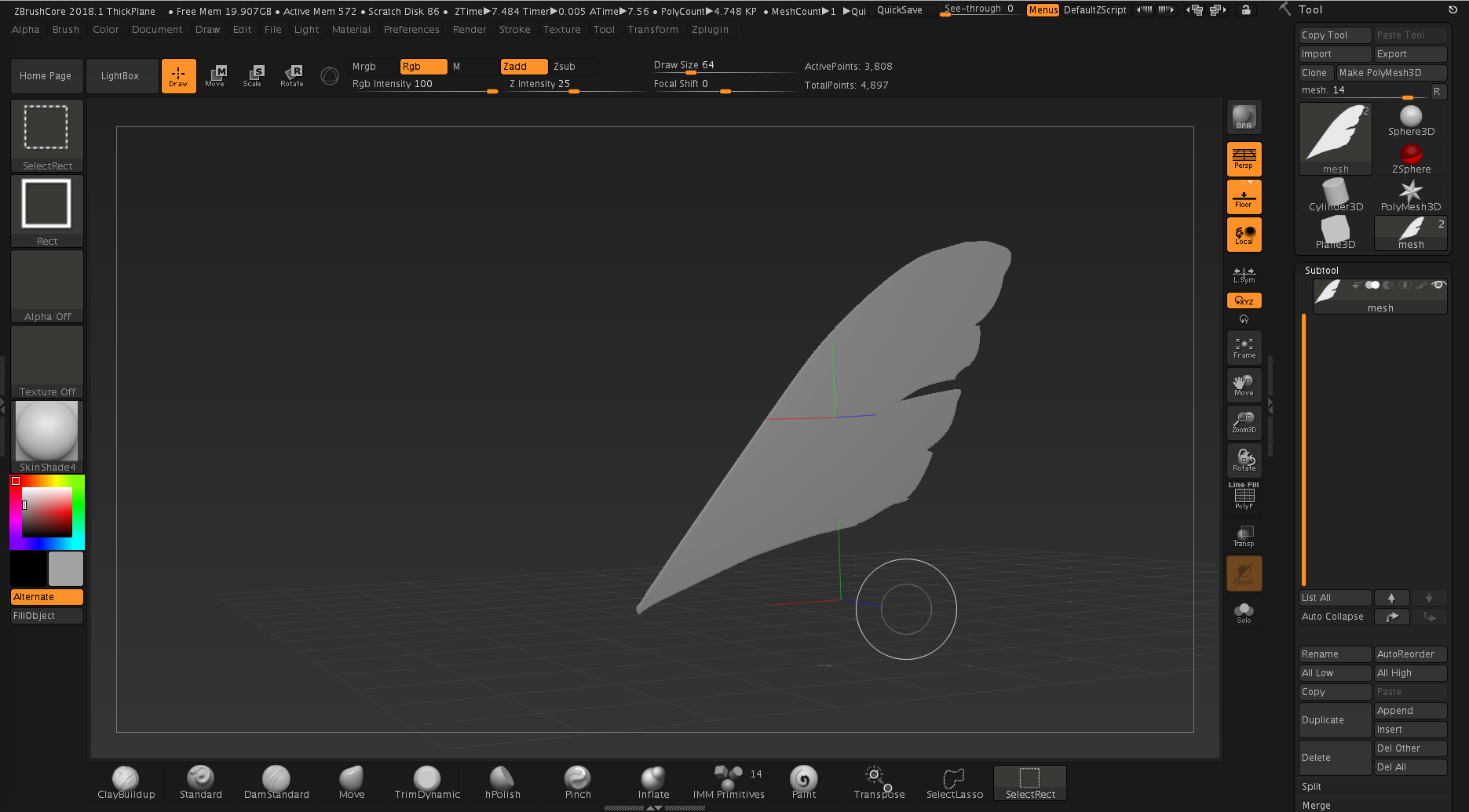

I had this same issue, but initially I had a thick plane still there with my SVG created shape attached to it, and this method didn’t delete the plane only.
I imported the SVG shape again, and this time clicked on the eye icon on the subtool palette for the plane, now the SVG file imported correctly and I’m assuming, cut the shape out of the thick plane.
I have a new issue though also related to imported SVG and text that probably has a basic solution that is not immediately obvious.
Although the SVG file I imported looks correct visually, just a flat cutout of a wing shape, I accidentally used the clay brush on it when I dragged without selecting a widget or move tool and for some reason the vector shape that I had inside the original Illustrator file (the veining inside the wing silhouette) is getting sculpted onto it!
Why would that happen?
In Illustrator, I had the veining part hidden with only the silhouette selected and that should be all that is there in the exported SVG file.
I did try to make the veining shape with the SVG file that should contain the veins only but that extruded as if it were the same file with just the silhouette.
Do I need to delete everything else in Illustrator when I export SVG’s? Or is the brush using the failed vein SVG import attempt as some kind of clipboard data and ‘pasting’ onto the shape?
