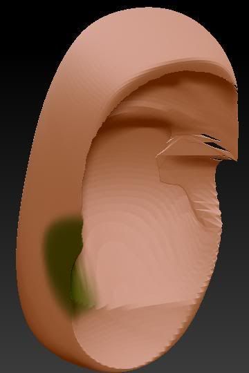

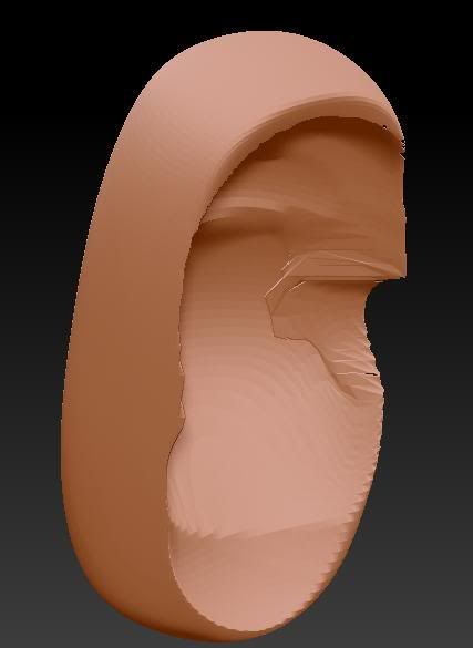

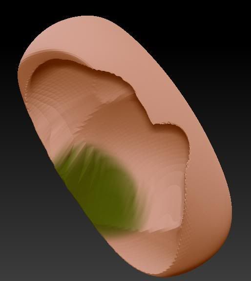

Let’s say I have a mess like this one (click here), and I paint it on one side like so (click here), how do I keep the color from bleeding over to the other side like this (click here)?
Is there a toggle switch for the brush to tell it not to paint of backfacing surfaces?
Turn on Backface Masking in the Brush palette.
Thank you so much! That’s exactly what I was looking for.
