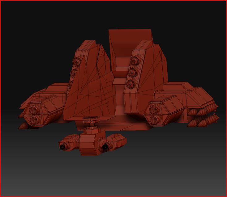

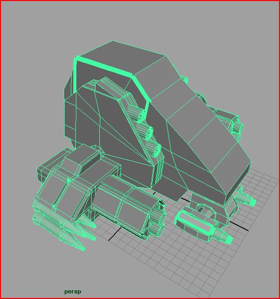

Unify your normals.
In Maya hit unify normals then hard edge them.
Export as Obj with ALL of the features turned off.
Should be fine.

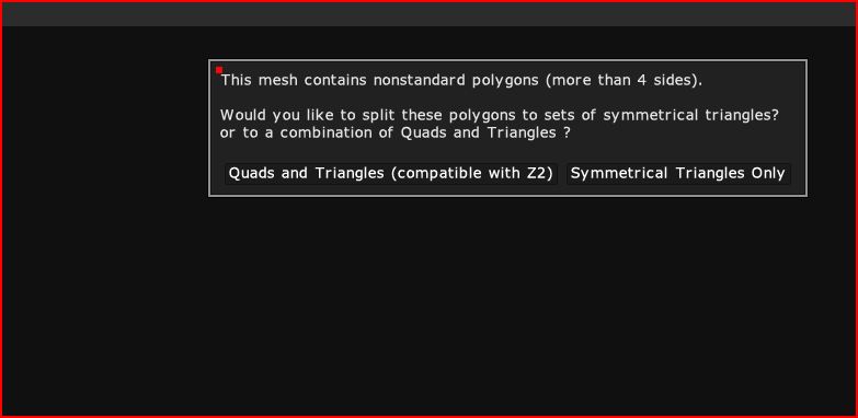

Oops, looks like you haven’t welded the verts properly, so just take the above advice as an afterthought. The error that ZB is giving you means that your geometry is not completely solid.
“Oops, looks like you haven’t welded the verts properly, so just take the above advice as an afterthought. The error that ZB is giving you means that your geometry is not completely solid.”
not quite sure what you mean abot the above does that mean i got a leak somewhere!! what the the best way to check? cheers
Go into polygon properties in Maya and increase your edge thickness for borders. It will give you a visual guide as to where your verts aren’t connected. Also you can find Mel Scripts to tell you where you have Ngons and bad geometry. ZBrush likes quads and Quads make a better Sculpting meshes with predictable results.

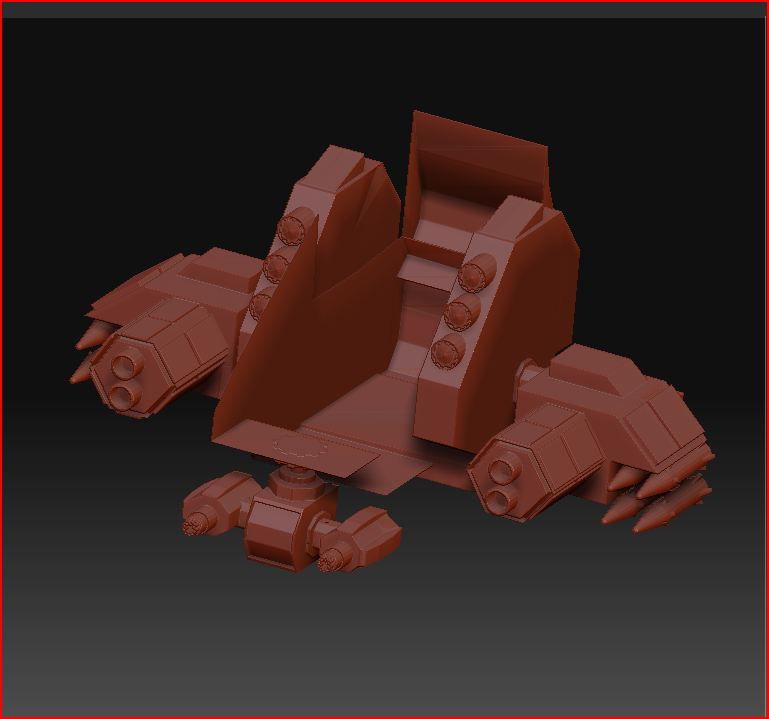

where can i get this scripts from might come in handy?
