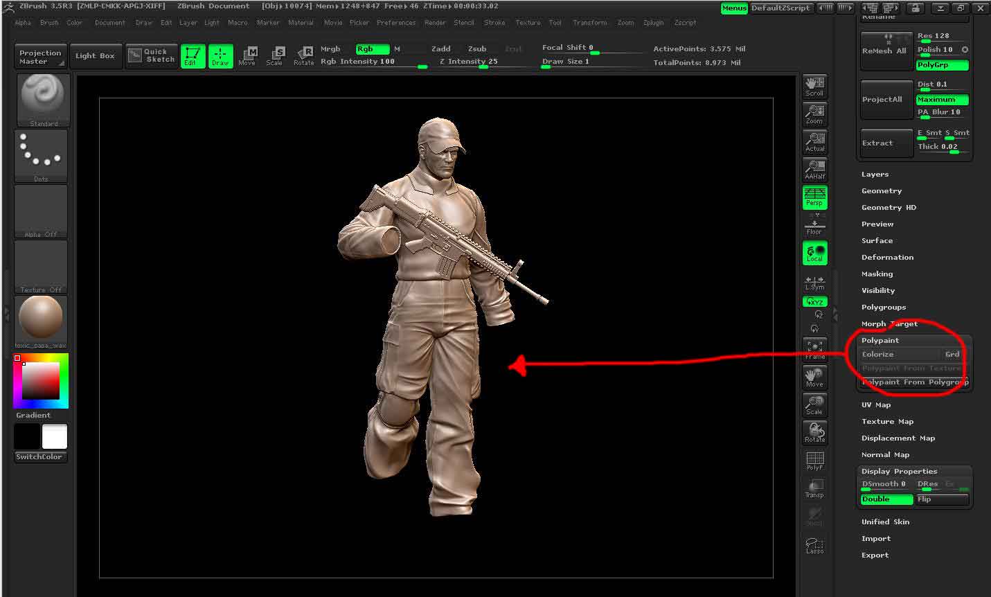

Not sure what I did but I would like to undo this.

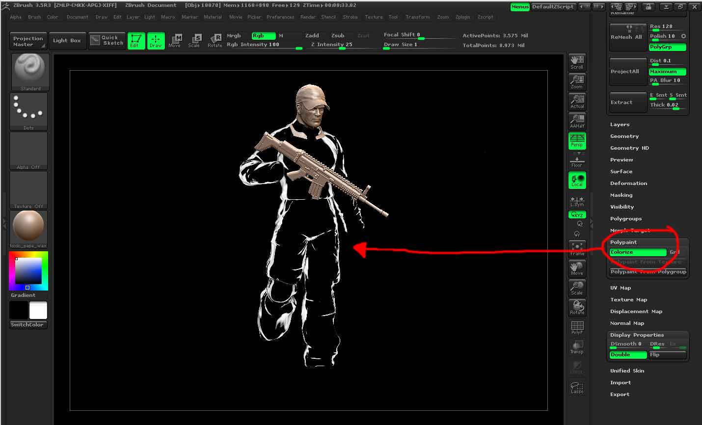

The “outline” material seems to have been permanently applied. When the colorize button is pressed you can see what happens. Because of this I am not able to polypaint. (well, I can but the material is wrong). Can’t figure out how to undo what I did.
Any help would be appreciated.
turn off RBG turn on M
select the mesh
go to highest subD
select the FLAT COLOR material
color>fill object
that will remove the outline material and you can switch between materials as you see fit.
Awesome, this worked good. Thanks for the help.
