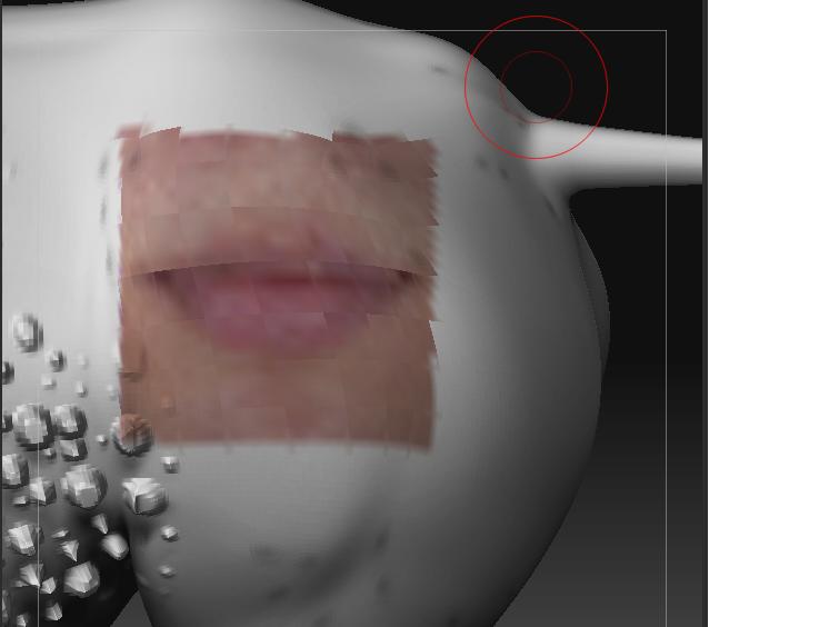

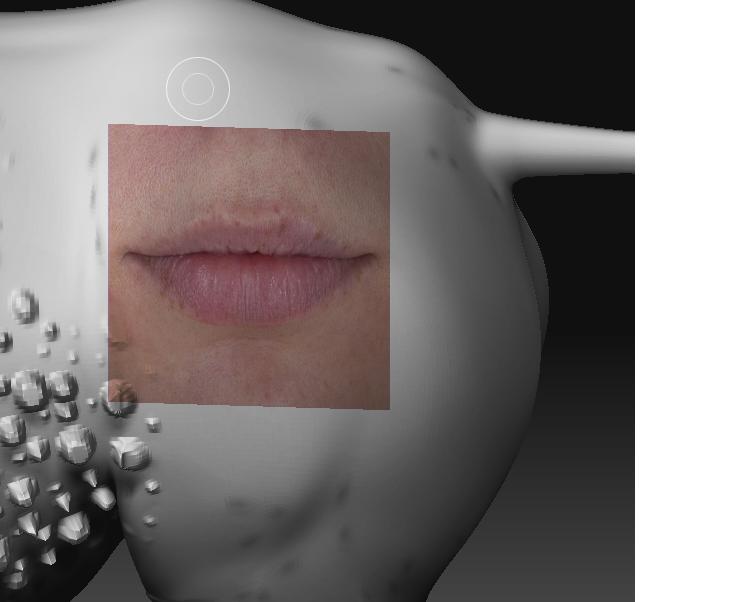

hi guys
i have prob with projection master
this occurs when i pick the dorp option in projection master
why it happen pleas healp m e
hi guys
It looks like you probably have Draw>Perspective turned on before you drop the model. Be sure to turn that off when working with PM.
thanku sir
but where from i can off my perspectiv in zbrush
i have turened off draw:perspective
but the prob is stil there
The remaining possibility is that your model doesn’t have enough polygons to support the resolution of the texture. Looking at the bit of sculpting you’ve done, I’m guessing that’s the case. It looks like the mesh doesn’t have nearly enough polygons for the painted detail you’re trying to achieve.
thanku sir
i understand what u r talking about
i will try as u said n tell u that it
do work or not
once again thanku
