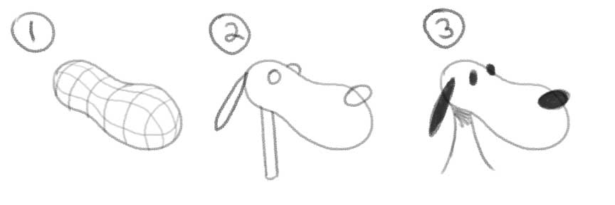

Hi, I want to create a simple dog head using Dynamesh. i have gone through the Dynamesh tutorials but I am still not sure how to create this properly. I guess I want to know what tools or brushes will will allow me to “form” the peanut shape of the head?

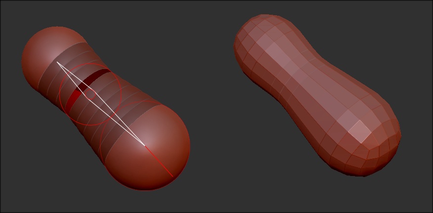

3 ZSpheres then Adaptive Skin then Dynamesh if you want.
