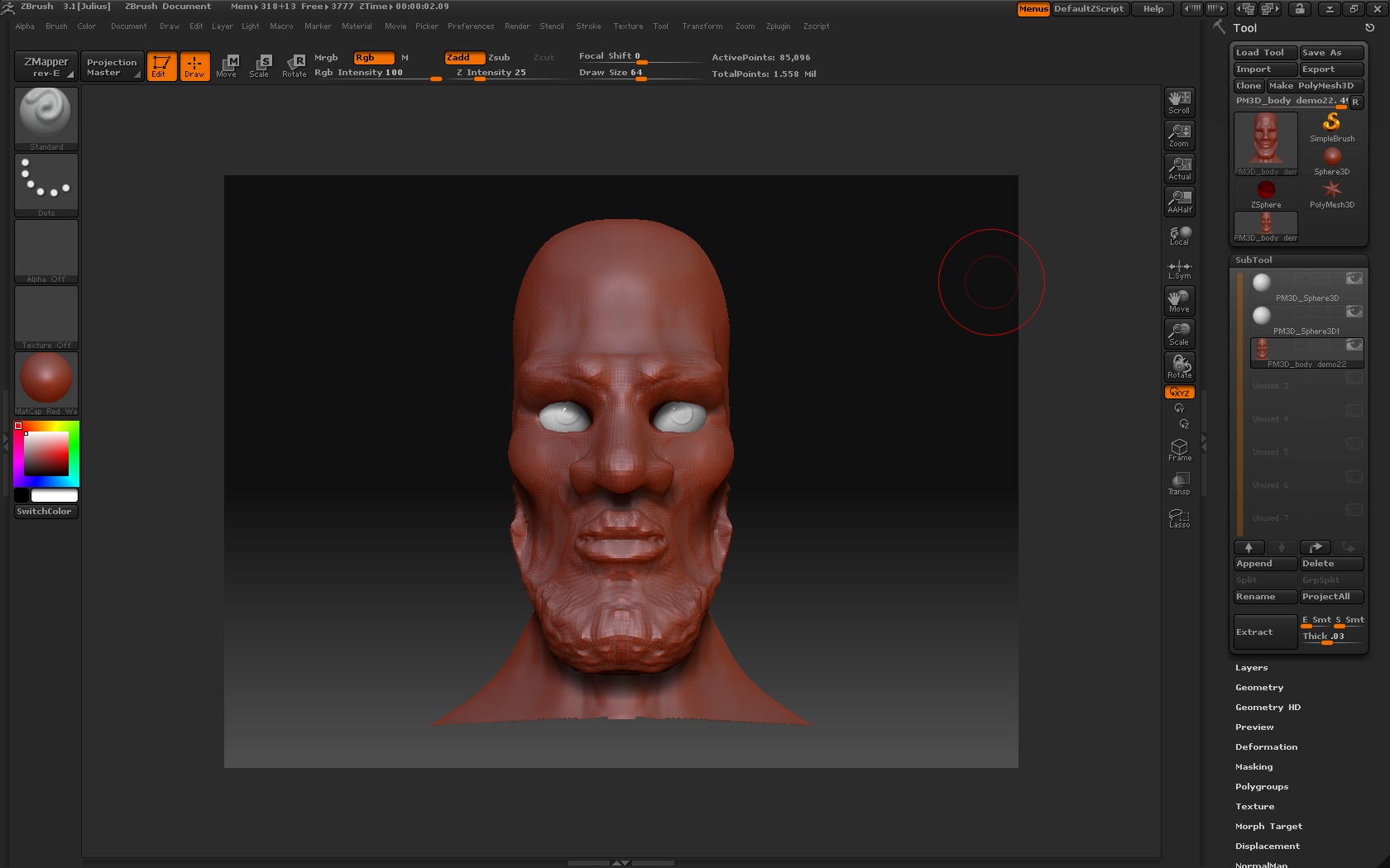

how do i make 2 eyes as one subtool?..and i don’t know how but the eye’s that i made some how made my model off centered so now i cant use symmetry any one know what i did worg?.. also do any of you know how to make a model hallow so i can the inside of the mouth and teeth on me own?
the plugin Subtool Master will let you combine subtools in one button click…as well as mirroring them.
Did you add the eyes to the head, or the head to the eyes? Every object that you append to a subtool takes on the center of the Starting subtool. So if the center was off on the eyes, then it will be off on the subtool.
From the looks of it you added the head to the eyes. Try it the other way around and see if that helps with the sym.
