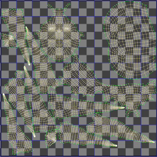

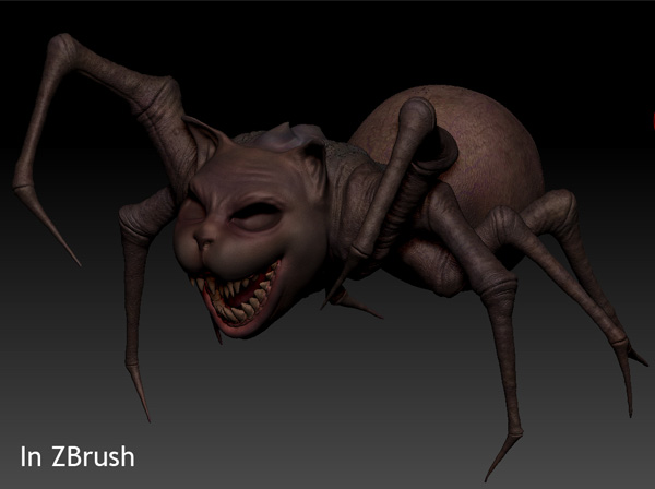

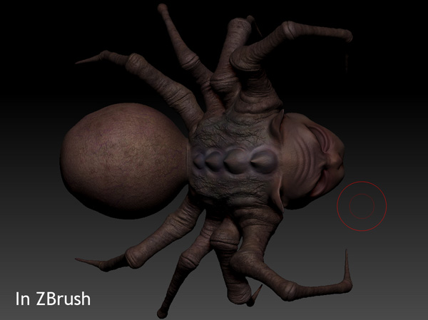

I am very new in ZBrush. Recently I did a “spider cat” in Zbrush and used UV Master for extract UV Map. This is how it look after I added in the colour and texture (file name zbrush1.jpg, zbrush2.jpg, zbrush3.jpg).

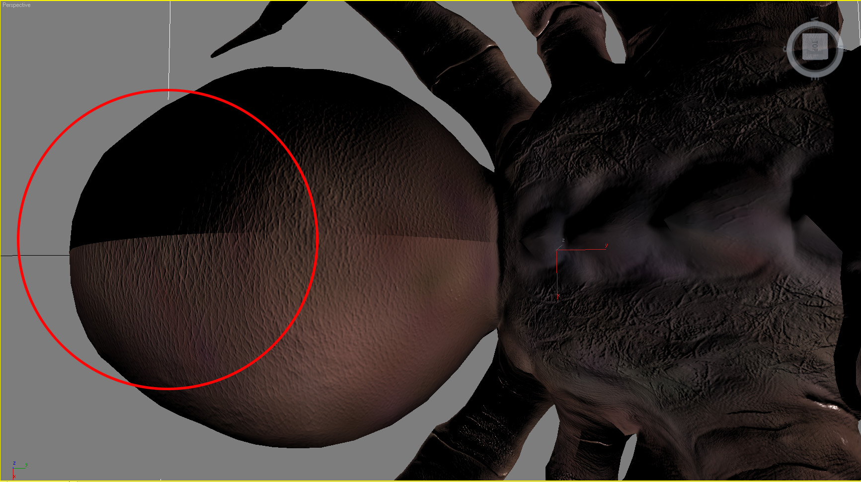

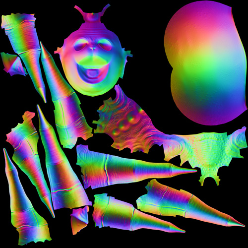

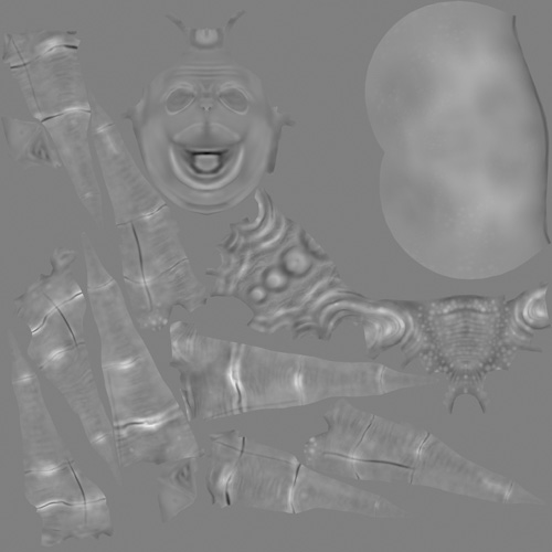

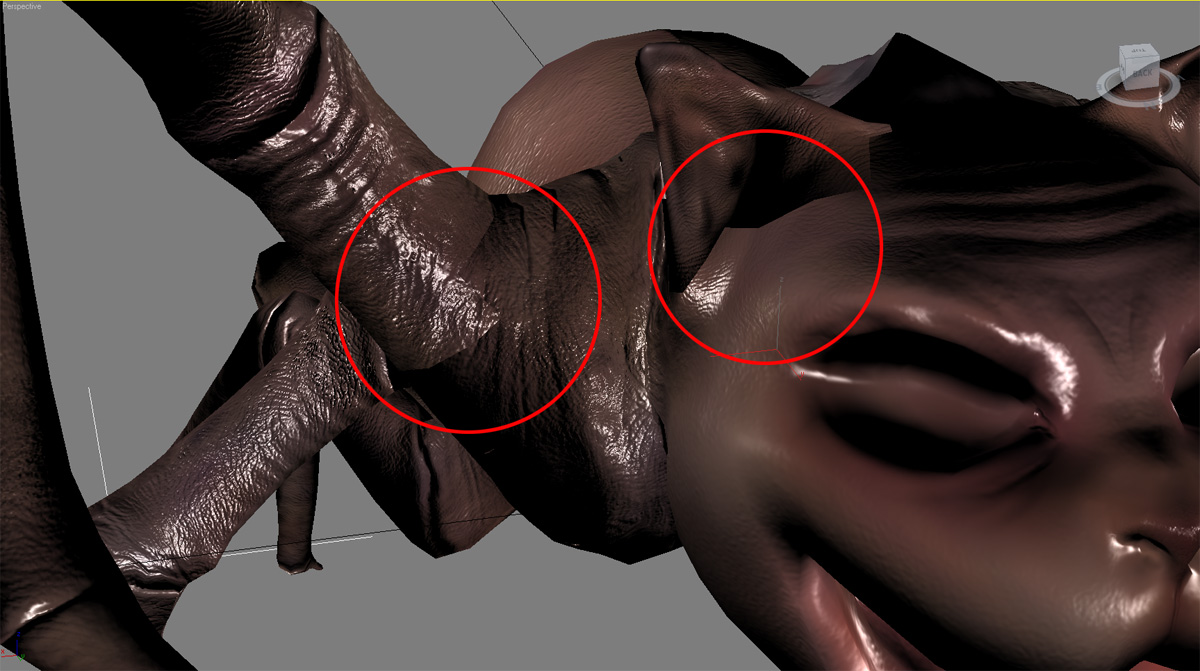

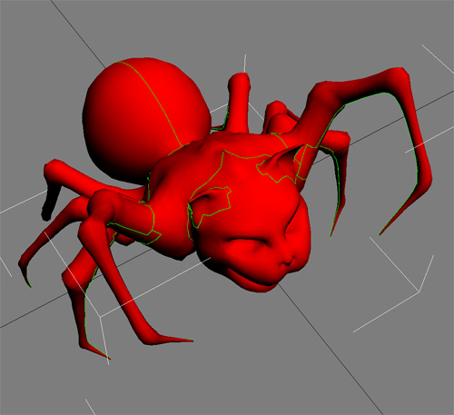

I guess I almost done and I want to render in 3DS Max. But I faced the problem… I imported the model as obj, after added in the Normal Map, Diffuse, Displacement Map. The model can see the joining part with line and different shade (file name error1.jpg, error2.jpg).

Displacement and diffuse maps worked fine. Its the normal map where the problem is. This here looks like a camera normal not a tangent n_map. Check it.
Thanks a lot! You are right! I just changed it and everything goes fine now. Thanks a million!
