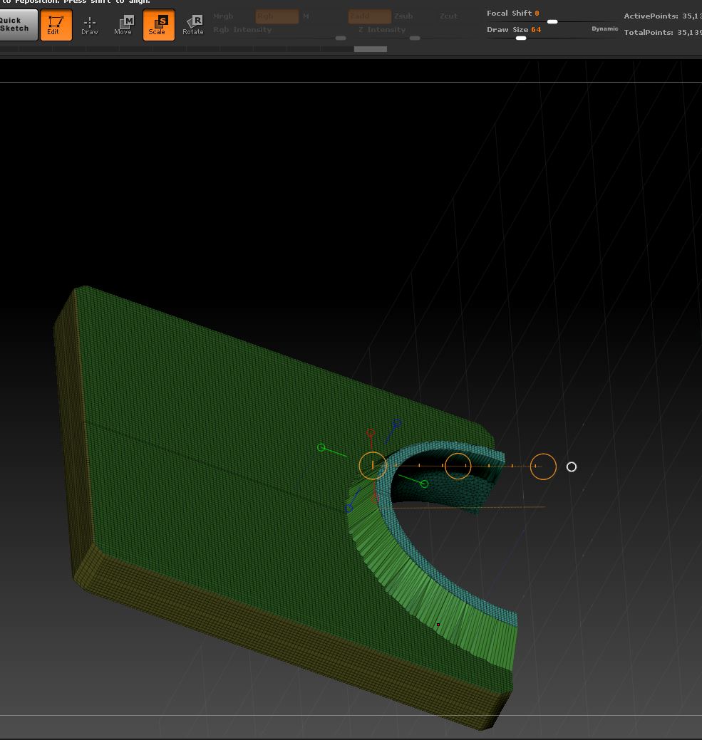

I’ve attach a pic of the quick and dirty process I used. A bit more care you would improve results
