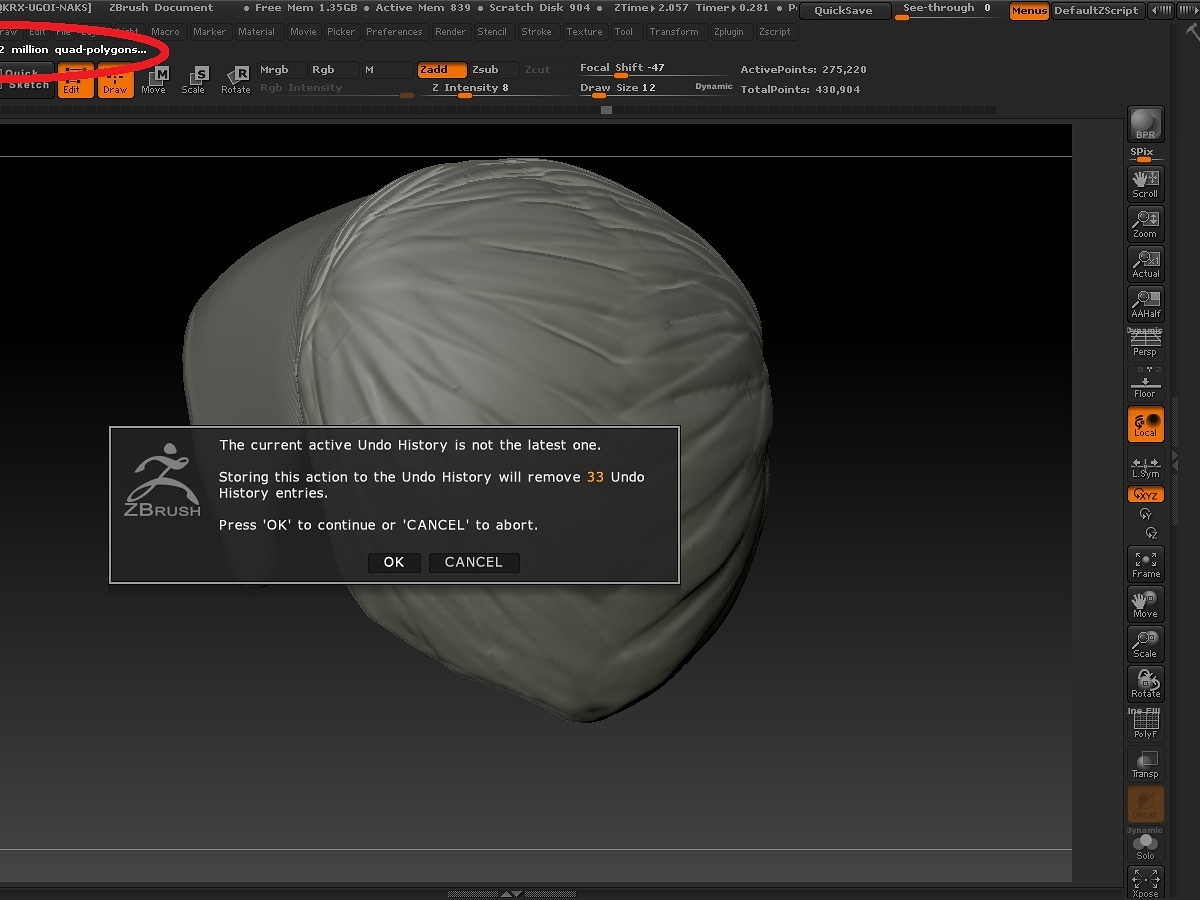

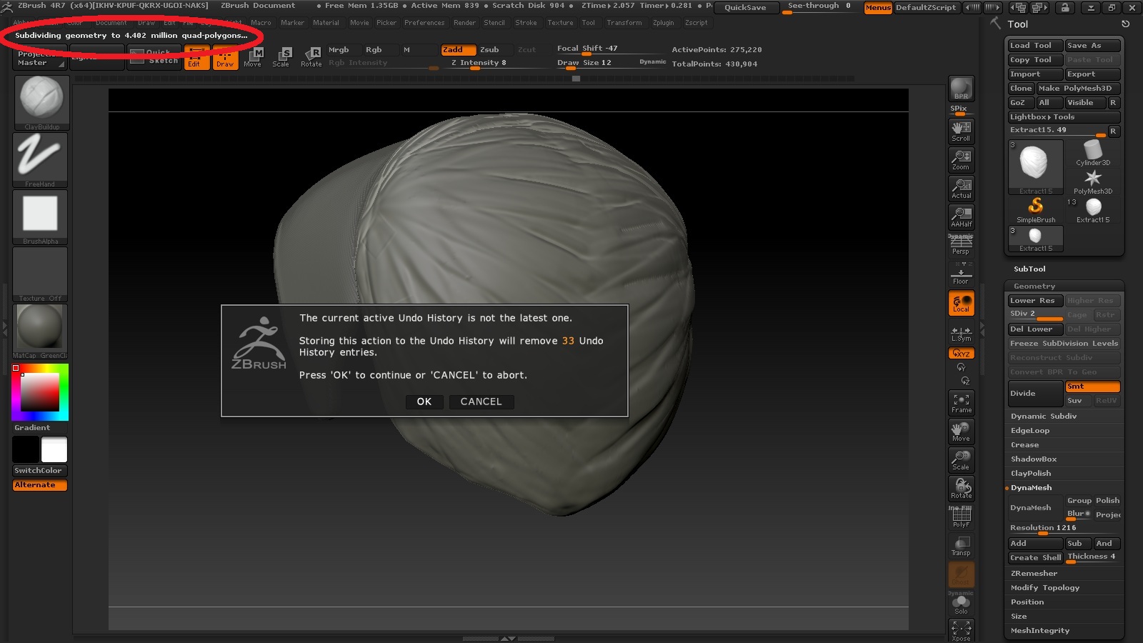

I don’t know what mistake I’ve made, today when i’m using the programme, the computer is keep calculating and all of my move is very slow.
I checked the polygon count, it should be okay and manageable, and i’m sure i’ve turned off the Dynamesh
I noticed the calculation is made on the top left corner, but i don’t know why
So what’s wrong with me?
Check if the Dynamic Subdiv is not enabled. If yes, disable it and try again.
thx much Totyo, that’s exactly the solution of my problem:cool:
