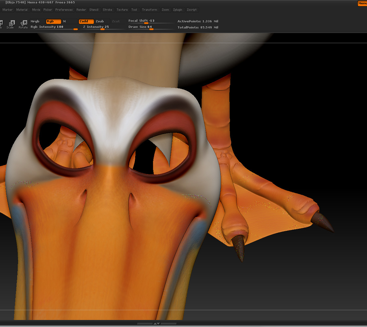

Hi,

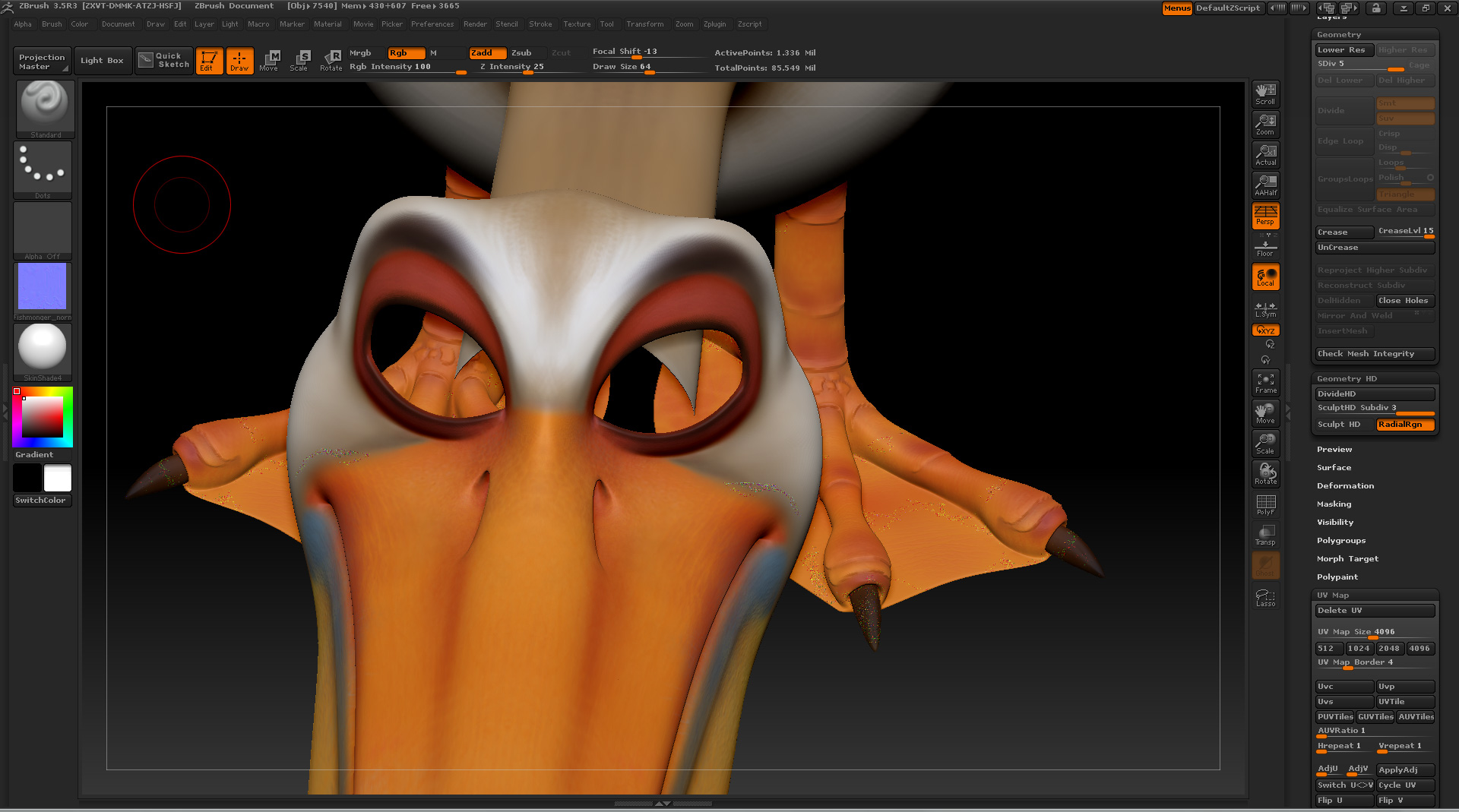

We are having an issue when we try to convert our polypainting to a texture map. See pic called screengrab1.jpg attached. You can see little multicoloured pixels all over the surface, especially around the corners of the mouth and on the feet of the character. The exported texture maps show the same artefacts, so it seems to be a problem with the actual baking process. See the pic called

One theory:
Your UVs may be too tightly packed. On a clone, run “New from UV Check” and see if there are any red spots in the resulting test texture. If so, space out your UV islands a bit.
Another test. On a clone, create PUV tiles (UV map menu) and do a “New from Polypaint”. Are the same areas a problem? If so, it is probably NOT the UV map (and probably means you should open a ticket Pix support to look at your model.) If the problem goes away with PUV tiles, then it strongly suggests a UV issue.

If you tried GUV tiles and had the same trouble in the same areas, then maybe the guys at Pix can figure it. Is there anything unusual about the topology in those areas? (I sort of discounted that as the sculpture looked pretty normal to me in the screen grab . . .)
-K
Ive been over the model to check the topology but didnt see anything. I will send the model as a tool to Pixologic and see if they can pick it apart. I suspect that its something to do with the HD tools.
