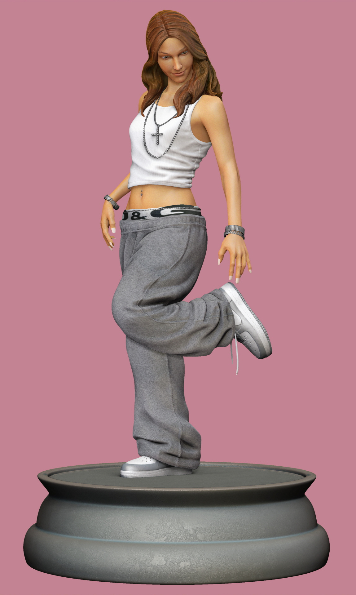

Silightly updated again
I like what you’ve done with her so far, but the sides of her upper body (rib area) seem somewhat flat and boxy atm, need to round them out more.
Hey let me just start off by saying i love this sculpt. Something has been bugging me about it this whole time though and i JUST figured out what it is. I feel like her knee should be lower. I looks fine in relation to her thigh but if you look at her shin it looks like she has absolutely no calf and her bone bends in a U shape that just feels unnatural. Her heel should have almost a straight line to the back of her knee and there should be some cushion there where her calf muscle would be for the folds in her pants to fall off of.
Thanks for your tips
Actually I’ve tried many passes on this work, and I am still trying to make it better. it is so hard man…hahaha
I will try smaller aperture setting that you mentioned. Thanks a lot for you tips!!
Thanks for your comment.
I will check the upper body again.
I think it’s because of rendering issue. let me check again.
Thanks !
I think you are right. I need to check the legs again.
Thanks a lot !!

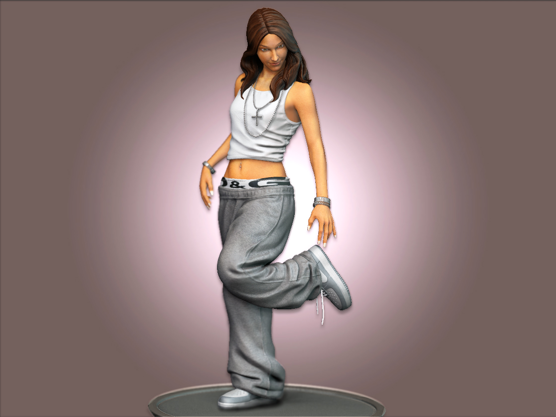

Here’s my update.
I tried to adjust Specs on each objects.
I hope this one looks better than last one
Love what you’re doing with the fabrics here, just gorgeous! whats your secret?
But, IMO, you could use an real image of the eye and make a zapplink to the eyeball. I would be more real and alive. That’s my opinion of course!
Thanks man!
I’m glad that you like my work.
for fabric, i’ve composited different materials in Photoshop.
I used dark cavity material with flat diffuse map, and combine them in Photoshop
yeh I think you are right. even though I used zappling and eyeball shader, but it doesn’t look as what I wanted. I think I need to try again.
I will put up my update work later.
Thanks
That would’ve been my guess! If you get time, could you elaborate a little? eg: how you generate a flat diffuse map, and what opacities, blend modes, and settings you use in PS. Much appreciated!
ok. to generate a flat diffuse map, I used Flat material and GrabDoc in texture menu. so I generate different maps from this menu such as SkinShade and dark cavity material. and combined them in PS. first of all, I put diffuse map under them with normal layer setting. and top of it, I put SkinShade map with 21% of darken color mode. and top of it, dark cavity map with 66% of Darken Color mode and blen them togheter. I didn’t use any Spec map for the fabric.
I hope this tip will be helpful to you

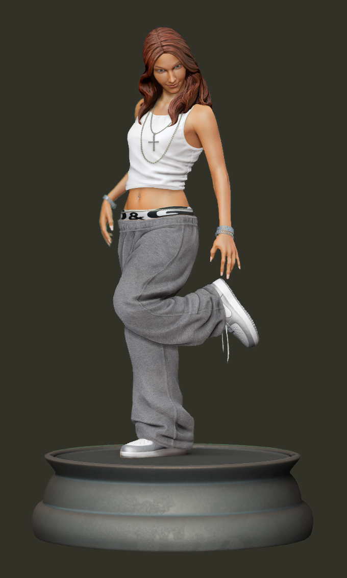

here’s my update.
I’ve changed eyes and specs on skin and hair.
I reduced the lights on over all.
All rendering is done in Zbrush.
I hope this one is better
very cute!..i would lose the long nails though and puff up those fingers a bit or dile down those knuckles?..GREAT work never the less.
Great job specially on cloths and shoe! but as already said work more on those nails and fingers, also when i saw her face i thought she has just woken up (idk, maybe i’m the one who is sleepy right now
)! so those eyes still need some changes.
