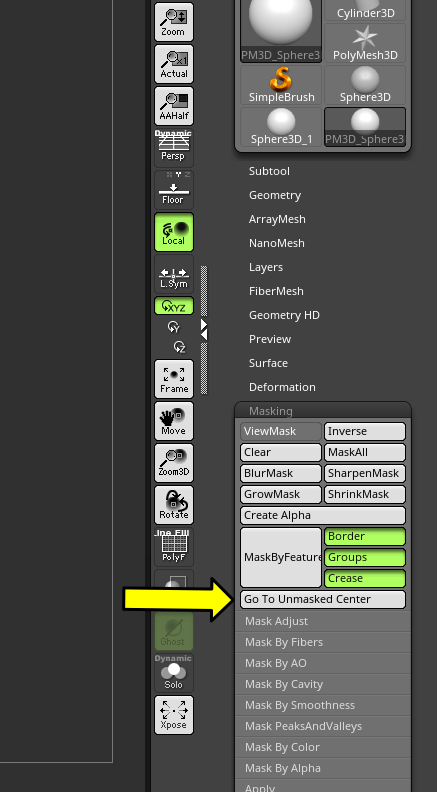

I had the gizmo unlocked in order to adjust it’s orientation and when I pressed “go to unmasked mesh center” it disappeared.

You could try this:
  1. Clear any masking for the subtool. (Tool>Masking>Clear)
  2. Mask part of the subtool.
  3. Invert the mask. (Tool>Masking>Inverse)
  4. Switch to Move mode so the Gizmo3D is active and then press Tool>Mask>Go To Unmasked Center.
Hey Marcus, thanks for chipping in.
I followed your steps, but I don’t have a Go To Unmasked Center button for some reason.
ZBrush 2018.1
Yup, it’s not there.
