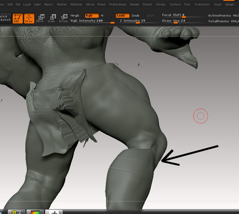

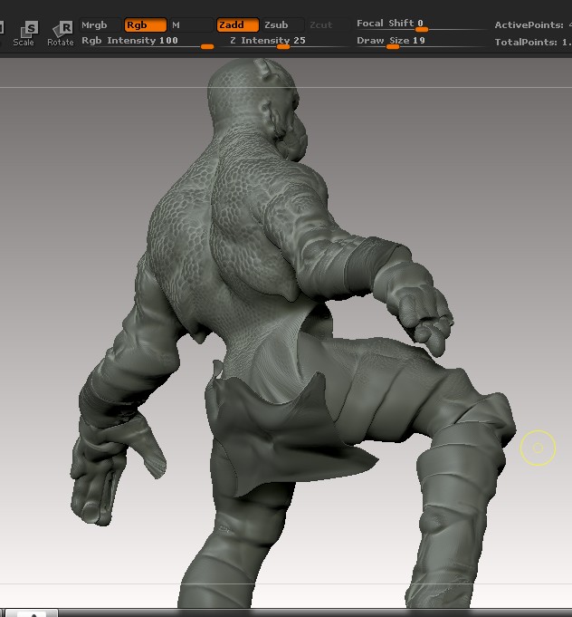

When I posed him in transpose master, he sort of crumpled into weird disc shaped parts. Any idea what I’ve done wrong? Thanks.
-Sam
-Sam
Hm, that’s strange. Did you use ZSphere rigging?
Yeah. I’ve got no idea what I’m doing wrong. I just tried doing from the ground up again and got the same result.
Could it be something I’m doing prior to trying to pose? I’m new to all this, so I’ve got no idea. Thanks again.
-Sam
I don’t know, I’ve not seen this before. Perhaps you should try posing him using just Transpose rather than ZSphere rigging, in case it’s something to do with the rig. (You could also try pressing TPose>SubT without any posing to see if you get the same problem.)
Well I’ll be, I tried just posing him with transpose, and began to get the same weird slicing/crunching look. It sort of looks like he’s a beer can being crushed. Hmmm…
Is your model very large? You can check by looking at the Tool>Preview thumbnail. It is possible that this is a scale issue. Other than that we’d need to test to see what’s going wrong. Could you possibly upload the model somewhere? You could delete the highest subdivision levels to make the file size smaller.
