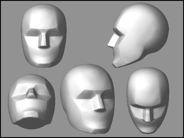

By presenting your model for examination - no textures, simple direct light, profiles + odd angles - it will make it possible to give a fair critique of your modelling efforts. And it always helps if you tell us what is the purpose of the model.

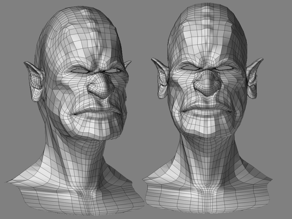

hope this post is what you mean. here are some shots of my lowest SD model front_persp_demon.jpg
please don’t look at the vert near the cheek I’ve already replaced that one
Not quite here is an exmaple :
What value is there in seeing wireframes when we are critiquing form?
With purpose I’m implying two things, what is the style your aiming for? - characiture, realism, toon etc.
Second, what is this thing? - man, monster, vampire, orc, happy, angry etc. And if its something really abstract or unusual you might want to even include a short description about it.
I derive these critera from the fact that form follows function - I critique my own work by saying first, does the bone structure, muscle placement make sence based on the ‘purpose’ of the character, and then I check to see how well I’ve executed the various elements of the model.
If you don’t have a purpose in a creation, a goal, most often then not during the generative process you become dissorientated as to the anatomical structure, features and all the other elements that go into making an exellent model - plus its really satisfying if you have set your self a character project and in the end achieve it :smiley:
I should say that its not nessesary to have the goal at the beginning, although I think its better, just that somewhere through the modelling process its important to define a goal to bring harmony between form and function. If you observe my Conehead zscript thats exactly what happened about half way through.
