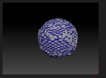

Problem: When I edit the “H repeat” value in the UV map menu to “2” and click “PUV tiles” it seems to make 2 8k UV tiles- but zbrush maps geometry over the seams of the 2 tiles and makes all kinds of artifacting in the texture. When I poly paint on the same model and press “new from polypaint”, the uv is made but its very fragmented and in the wrong place. Is there good info on multiple UV tiles out there or am I going about this the wrong way?
the screenshot is a sphere that I uv’d with 2 tiles and then textured it with a grid. The screenshot is what happens when I apply the texture to the UV.
