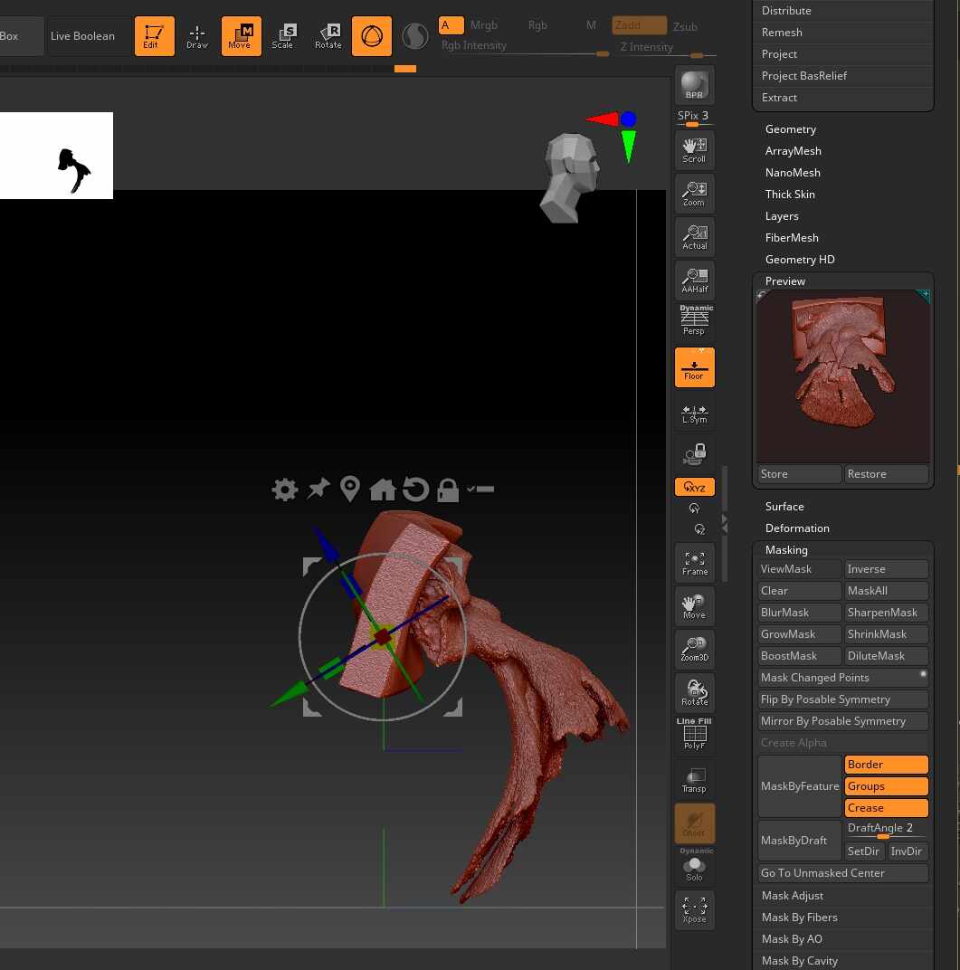

Multiple Imported STL Depth + Unify

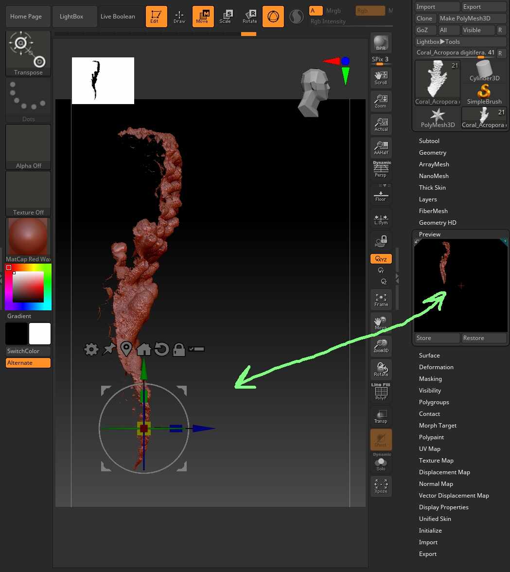

What is the “Preview” window relationship to the Gizmo3D?
How to make sure Imported object Z Depth is in front of the Background?
Also, trying to move or Rotate, “CLEAR MASK” is not helping, something is affecting the mesh.
Currently if everything is moved/rotated in the tiny preview window all works as expected.
Using the main screen results in twisting and distortions , because some invisible force is masking or clearly effecting the mesh.
  1. Imported multi-Append STL files and Unified them.
  2. Now, trying to orient and place pivot.
Some Imported Mesh are behind the default background (and are not visible because they imported so small)
