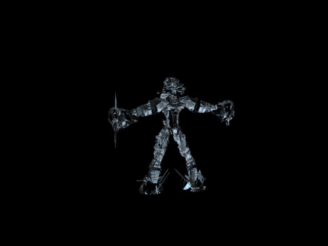

messup.jpg here’s a screenshot from vray 1.5! …

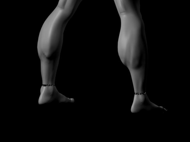

Earlier last week, when i imported my mesh from max to zbrush for the first time, i was having some unwelded vertex resulting in some gap in my mesh once in zbrush. When i resolved my welding problem in max, everything was fine back in zbrush. But…Now it kind of came back in max when i render!
Any ideas how i could correct that?

Still trying to figure out my problem… i tried to render my mesh without the displacement map, and just the exported zbrush obj. and everything’s fine.So the problem comes from my displacement map. It’s as if some polys were deleted on rendering…

Hmmm… that screenshot is pretty bad.
How’s it suppose to look over at zb?

Perhaps you’re experiencing UV renumbering problem. Can you try exporting your lowest level mesh out of ZB into max, then export it out of max, and reimport the lowest level mesh into ZB and see if it blows up? If it does, it would explain your Post#9
You should then check out some max user tips on fixing exploding mesh in this forum. It is a problem (glitch or something) with max obj exporter. I don’t use max so I can’t help any further if this is the case.
For Post#10, the welded mesh shouldn’t reappear. Perhaps you’re using wrong version of your mesh?
