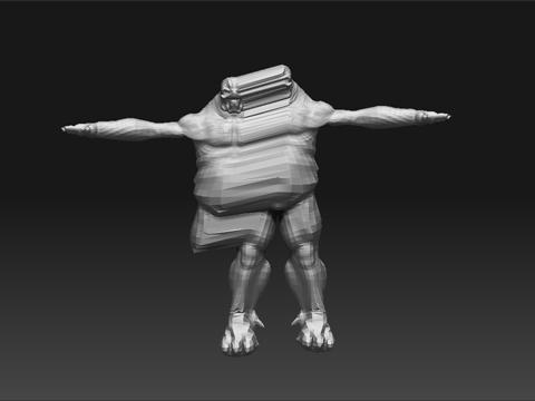

Move tool doesnt move all of Sub-tool
As you can see, the tool doesnt all come with when i use the Move Tool. Im not using the Brush, but the Move (W) function. I skimmed through a few other posts mention issues and i can Tell you that…
No, i dont have any masks on the tool. I’ve clicked Clear numerious times.
and No, i dont have Activate Symmetry On.
Plz help. I want to move stuff like everyone else. Thx for the help
Are you intending to only move one side of the model, but have symmetry active? That’s the most likely possibility from the picture.
Alternatively, it might be a scaling issue. You could try pressing Tool>Deformation>Unify and see if that resolves the problem. But your illustrations look like what can happen with symmetry active.
Unify did the trick. the Tool shrunk quite a bit and now i can move it without issue. Thx for the help.
Now a 2nd issue using the Unify. i have a bunch of Sub-tools attached to my Character here. They’re all Scaled and Positioned correctly, but when i Unify all the sub-tools, they all shrink and their Scale / position doesnt match where they were previously.
Like if he was holding a mace that was scaled to how i liked the perportion and put in his hand, Now its just as tall as he is and in the middle of my Base Character mesh.
