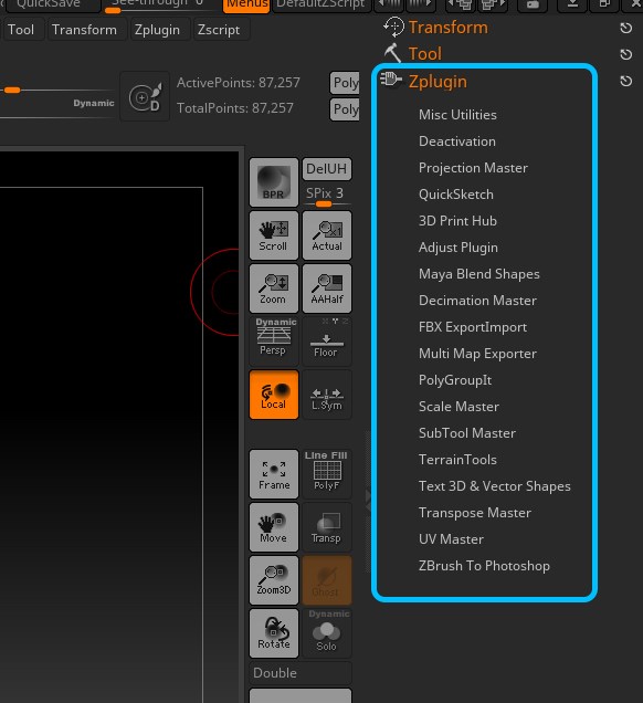

[Edit] Ah wait. I think you’re probably trying to drag from the collapsible plug-in title in the plug in menu rather than the plugin button. Click on those titles to open them, then the actual UI button should be in there someplace.
If that doesn’t solve your issue, then we’re back to where we were previously.
Got it to work,
I wanted just Terrain Tools, but got the whole list of Plugins…
even better.
Thanks for all the great help.
