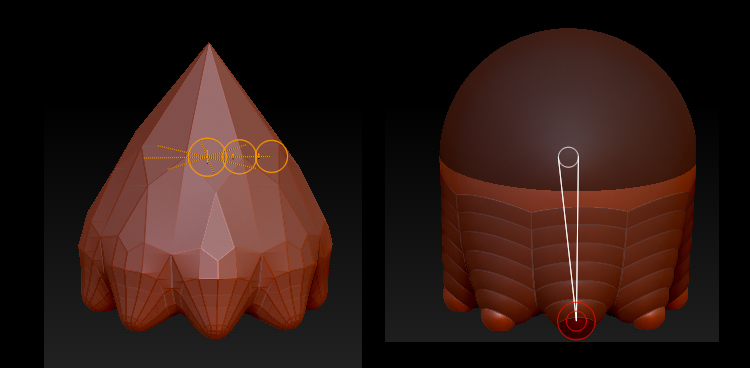

i’m trying to follow the more wine tut about making the squid thing but when i made the tentacles and press “A” to view what it would look like. But the first main Zsphere i made kind of collapses. it forms a point instead of staying spherical. i have tried changing the size of the tentacles attached to the main zsphere but it still collapses. how can i fix this?

this is how it looks like just to show you. but what do you mean put a zsphere over the top of the main one? it just joins onto it or turns the sphere i’m trying to model into a 2D shape.

Go to Adaptive Skin submenu and turn on ‘Use Classic Skinning’.
ah many many many thanks zber2! worked like a charm :smiley:
