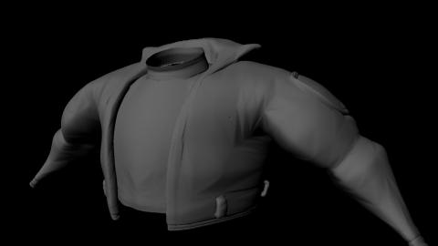

so i applied the image as a displacement to my (scaled down) model in maya and it comes out as a big blob with the disp obviously overpowering the original model. When i tried scaling my model back up to 1 again the displacement no longer blew out the model. You could now almost see the sculpting but it is now far too weak and low resolution ( see image ). The disp map resolution was 2056 sq

The model getting freaky when you divide it is probably due to a scale issue. In ZBrush, look at the Tool>Preview window. How big is the model relative to the window? Probably really large.
Maya may have an export setting that can scale the model down by a certain factor when you export it. That’s the best way to go. Alternately, in ZBrush you can use the Tool>Deformation>Size slider to scale the model after you’ve imported it. By using that slider, you can decrement the model by a specific amount, which lets you scale it back to what you started with if you’re going to need to export the model again. (For example -75 would leave it at 1/4 size. Size 100 twice would then return that to original size.) Of course, if you’re only going to need to export the maps and won’t need to export the model again you can simply use Tool>Deformation>Unify instead of messing with Size.
Regardless, be sure to store a morph target after rescaling and before subdividing. When you return to level 1 to create your displacement map, switch to the stored morph target. This restores the original base mesh without any influence from multi-resolution division smoothing. It’ll give you the most accurate displacement map and avoid bloat in your render.
