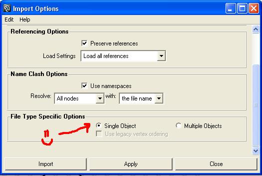

Your zbrush workflow is fine, but when you import in maya, you have to configure the obj import settings and UNCHECK “Create multiple objects”
Thanks, but like I said I already did this, and the problem also occurs when I don’t even touch the obj in Maya but right after exporting from Zbrush just instantly import it back. So it’s not Maya.
