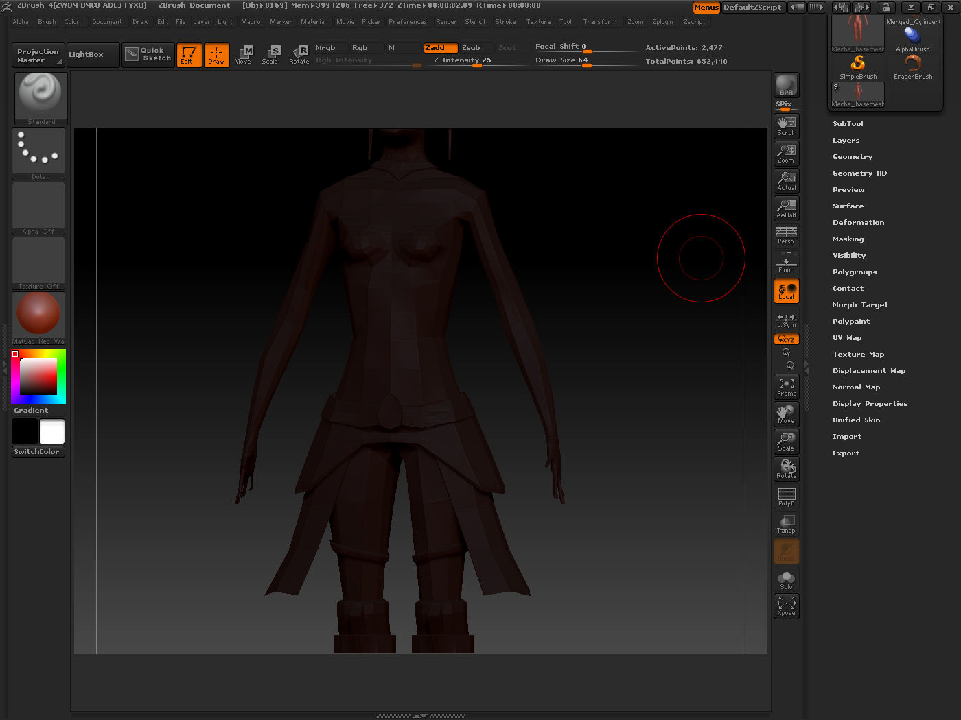

Hello,
I’ve encountared a problem that google can’t help me fix and it’s driving me crazy. Basically a certain model appears dark…as if it’s fully masked.
I tried switching colors (pressing v)
Tried loading on a different machiene still same problem
Tried loading a different model on my machiene it was just fine.
Tried painting/dif materials
Tried adding lights
When i Shift+R it the material appears the way it should.
I think i played with almost every slider i could find. Always reseting it to it’s original state after seeing no change.
I’ve hit a wall here. Really hope you guys can help me.
Thanks in advance
Try pressing Tool>Mask>Clear
It’s not masked.
I can still work on the model.There is a very slight colour difference between masked an unmasked places. The colour’s just off.
