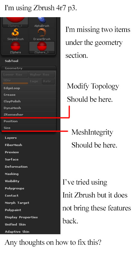

Can anyone help me with this problem? I seem to be missing the Modify Topology and MeshIntegrity submenus in my Geometry menu. I’ve tried using Init Zbrush to get them back but it’s not working. I’m using Zbrush 4r7 p3. Thanks.
You have a ZSphere selected. Make sure you have a Polymesh (such as the Polymesh3D Star) selected and those sub-palettes will be there. The interface items in the Tool palette vary depending on what is selected.
