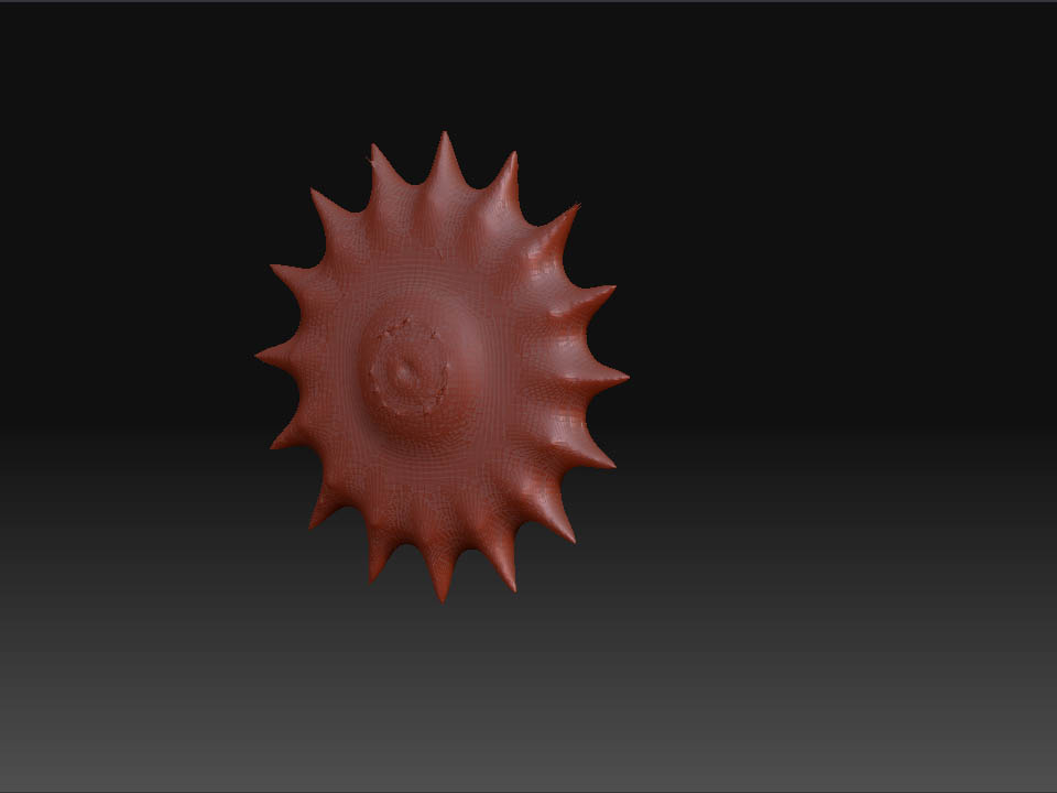

Hmm, it still has those small spikey defects in the mesh! I’d hoped they’d fixed that for Z3.

the spike are produce by the alpha to avoid thta set the focal shift -100 (that impede to blur the alpha) and voila!
Andreseloy
