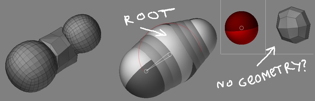

The root ZSphere’s value cannot be changed. It does not have any geometry in and of itself, and so changing its value would be meaningless.
ok thanks!
tokiop…i haven’t tried it on a base sphere but…try the zscript XYZ which can be found in the scripts forum. It may or maynot solve your prob. In any event it is a must have in a zbrusher’s arsenal of useful things as well as many others found in that forum.
But when Iam trying to add new hi res ZSpheres to the root sphere, mesh where the root is placing has smaller resolution. So the root zsphere define geometry with smaller resolution (depending on value in mesh density slider).

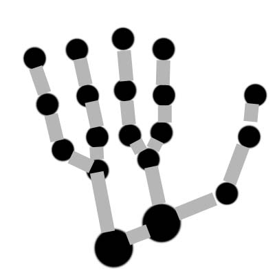

:rolleyes:Yes i have this too… :mad: it’s nearly impossible to create 5 fingers on a spehere
That is because you need to think of zspheres as a cube, with 6 sides. This makes it impossible to have all 5 fingers as 5 branches out from one “palm-sphere”. You need to “cheat” by having more branches inside the palm. Something like this picture i made. sorry that it looks crappy, but it should get the point across.
alek
Check out the “hand setup” link in my signature.
