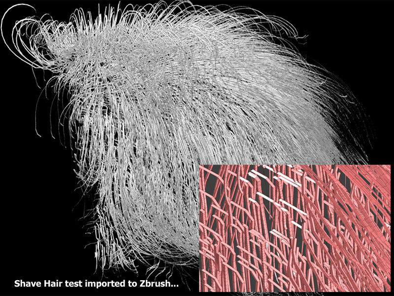

Has anyone ever tried creating hair in another program like shave and haircut and then bringing that hairstyle into zBrush?

Greetings jBibble …seems like you’ve already gotten some great answers in your thread from Derlandvogt, Jason Belec, and Kircho.
I emailed jAlter about it and he warned that once converted, the poly count can get heavy in maya pretty quick. Yep, yep…
So I did a little test by converting the model’s shave hair to polys and imported the OBJ into Zbrush.
600,000 polys on this wig, kind of heavy for a hairdo don’tcha think?
Seems Bas Mazur has it going on for zbrush and photoshop hair… Hey Bas!:slight_smile:
Nevertheless your question is a good one, because some other non-hair related things could come out of working with Shave and ZBrush together.shave_to_zbrush_test.jpg

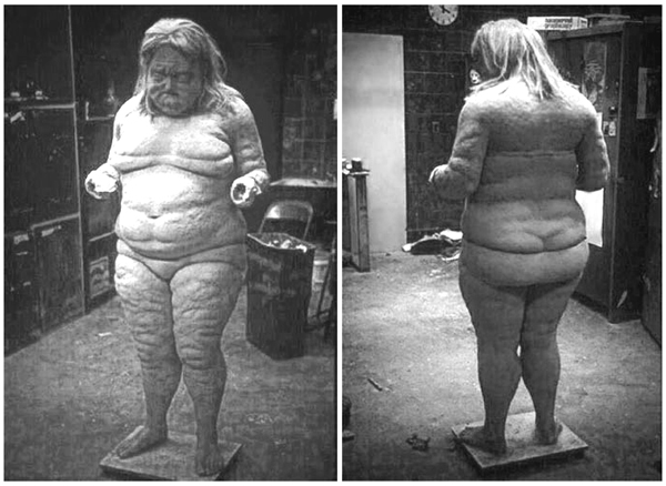

Really not sure if it applies to the Zbrush focus here, but since you asked, I’ll oblige a little…
Yes for the material: Most of the work has been done with fired clay, not everything, and more recent works not at all…
Here’s an example of a clay piece when it was in progress, unfired at this point. (The hair is a wig, not clay)
If you’ve ever taken a pottery class, or watched someone throw on a wheel…
you’ve realised there are two sides of the clay wall being worked on the hollow form, often at the same time…
and that’s an important difference from working solid on an armature, a very significant difference in this case.
Just to back up a little, you start with the feet and build the hollow form upwards, like laying bricks,(or clayburgers).
and then when the clay wants to fall, you stop, cover the edge with plastic (as shown here at wrists), wait for the exposed clay to set.
So you’re creating a foundation onto which you’ll add more weight. Once set, unwrap the plastic, continue up from the fresh wet edge…
Only when it starts to fall or sag do you stop and wrap the edge…patience is a virtue. No interior steel or wood armature needed.
Now and then I’d use an exterior prop to hold the form in place while the clay sets to a leather hard state.
Bas you may ask,“But why Joe, why do it this way?”
Easier to sculpt (imho) when you can work from the inside as well as the outside.
Let’s you sculpt the internal ‘pushing out’ we all seem to have in common, and the push doesn’t destroy the exterior detail either.(!)
Easier also because no molds are needed, the fired clay is the finished piece. (Although molds can be taken of course at anytime).
Cheaper too, water based clay costs very little. Found objects, mixed media costs very little as well.
So it’s the analog version of zbrush et al, in that you’re basically sculpting a hollow form. Goes way back in time this process.
Eventually the negative aspects of this material, (fragility, heaviness on a large scale), made me search for other options…
Epoxy, a non toxic one. Lately I’ve been carving foam and covering that with a non-toxic sculpture epoxy that is almost like water-based clay.
You can smooth it with water, texture/emboss it, just amazing how close to clay it is. Sets hard, paintable, magic stuff really.
A comparison to zbrush would be using foam for divisions 1,2,3, and the epoxy at divisions 4,5,6…for all the detail.
