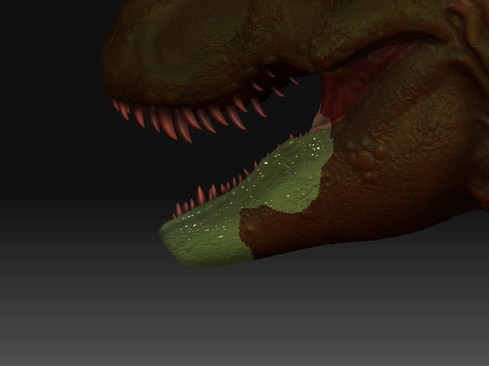

Material Problem. Pleasse Help
Hey Goobatastic, the problem you have is very simple to resolve.
What you did was, while sculpting you had material channel turned on ( m button wright next to the zadd and zsub) and what happens is that you paint the currently selected shader directly on to your model while you sculpt.
Anyway to solve this simply make sure that you have that m button turned on (highlighted in orange) select the flat color shader and go up in the color section and press fill object and that’s it.After that you select back the material you wan’t and continue working.Just make sure to turn of the m button after when you go back to sculpting.
enjoy
