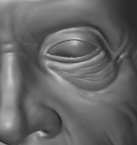

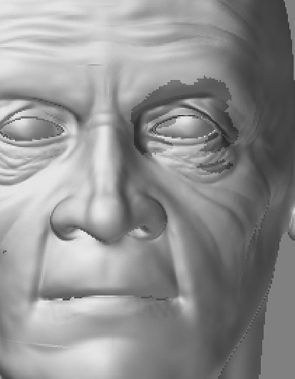

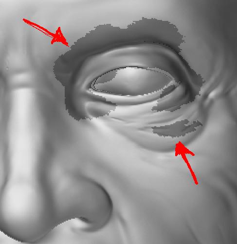

Hi, I have this wierd problem with my mesh. Everytime I load it onto my canvas, I get this darker material color around one of the eyes! And I tried changing the materials, restarting Zbrush, but nothing helps.
It looks as though you’ve got some of it masked. Try pressing Tool>Masking>Clear and try again.
Thanks- but that does not seem to work…

Here are two more screenshots… I’m sure it’s not masking of any sort
Perhaps you have colored some vertices by mistake. With your model in Edit mode, check that Tool>Texture>Colorize is switched off.
Yeah, that solved my problem! Would coloring the verticies become a problem later on when I plan to export any textures for that model?
