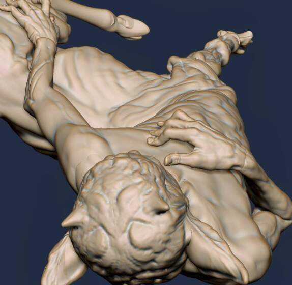

I change material settings,material looks like on this picture but in viewport anything not changed. How can ı fix this?I’m trying to make cavity effect on material.Thanks! DQDQD

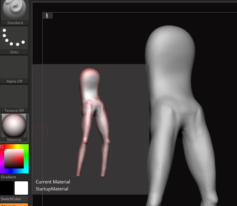

Thank you for the help zber2 but nothing changed
1- https://prnt.sc/zgy4ij
2- https://prnt.sc/zgy6nz
3- ht tps://prnt.sc/zgybah

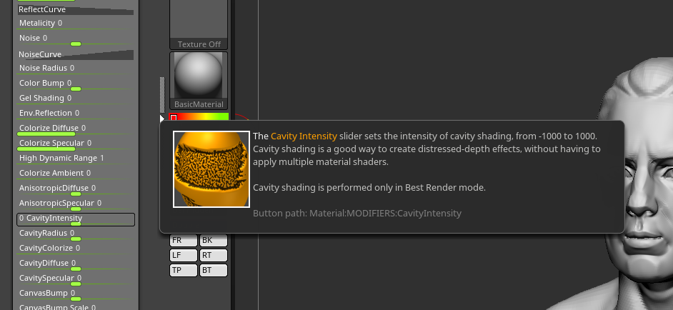

Hi @emreka
Are you using Best render, because Cavity shading only works in Best render mode.
I need to make cavity effect on viewport,how can ı set this?
You can’t. It doesn’t work that way. It only works with best render. You would probably be better off using cavity masking and polypainting.

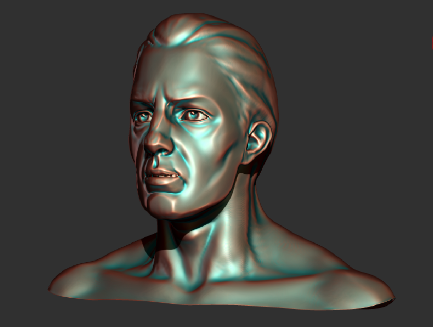

2021-02-14 09_49_06-Greenshot
but this?image
@emreka
There are other ways of creating a materials with that effect. Search Youtube for tutorials.
If this is the type of effect you are after, here’s a material you can use and study to see how it’s made. (From the Pixologic Material Library)
gw_oxide.zip (593.8 KB)
2021-02-14 19_58_18-ZBrush
