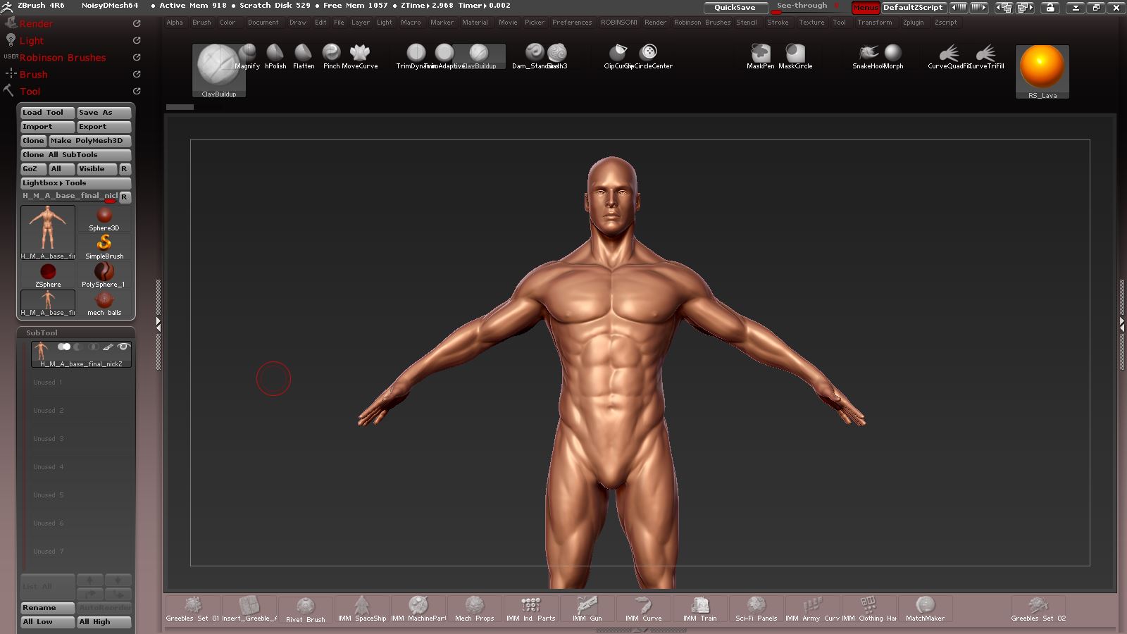

Hi there I opened the Ztool to a very well sculpted character by Nick Zuccarello. I am trying to change the material for this character but it does not seem to work when I try. Any suggestions are appreciated…
Try again after you update ZBrush to 4R6 P2.
May be the material is aplyed by Fill Object. In That case you have Three options:
1- Select the new material and with M channel enabled (Under Draw palette), then go to Color -> Fill Object
2- Do the same process but fill with the flat material. This way will deleted your material information, so after that you can select any other material and will change just as an initial mesh
3- Disable the brush icon in the subtool palette. This also turns off the polypaint information but works really fast of want to change the material preview.
Hope this helps
Thank you guys for the responses. Hazard that 3rd option did the trick. I must say I truly love your work and that displacement greeble technique is amazing and I can’t wait to try it out.
I was also wondering what do I do when I want to poly paint this model? Will that be a problem? It always puts on what seems to be a different material when I turn the subtool brush on.
