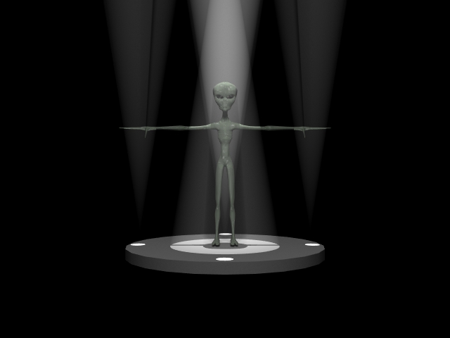

can anyone help me please to paint with matcaps. I followed tutorials but I can’t seem get to work ’
Thank you
