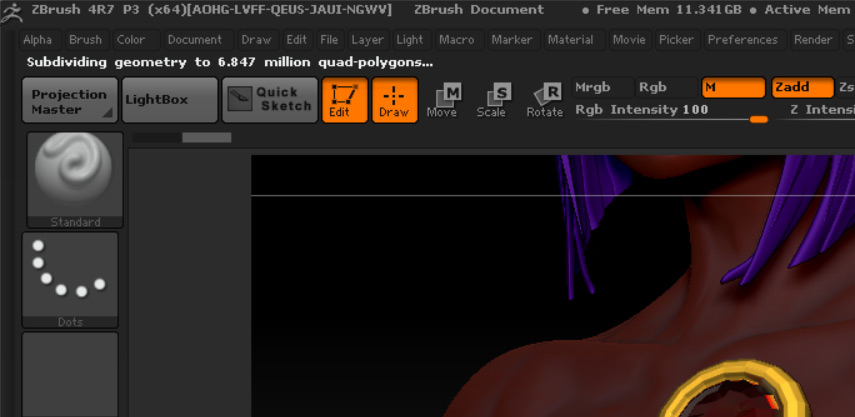

This message would appear every time I - 1.) selected this subtool, 2.) painted on the subtool:

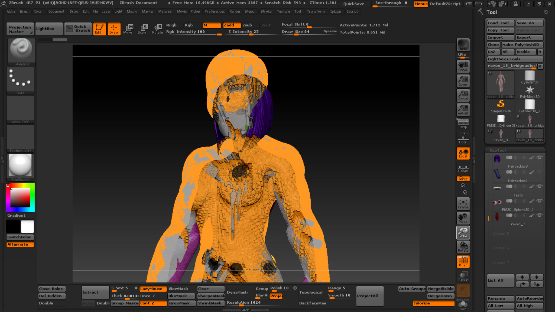

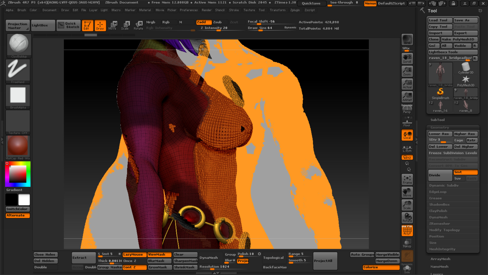

I noticed, that when I activated display polygroups, I would get graphical errors when transforming/rotating/zooming the canvas:

There was a glitch, where when I pressed the mesh to hide “Ctrl+Shift+Click” the polycount density would “appear to double” on the screen, even as the polymeter stayed consistent - As if a duplicate of the mesh was hidden inside it…
