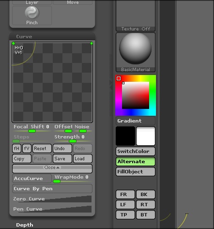

I’m using the maskpen tool + an alpha (my logo) with the dragrect mode. The problem is that my mask is a bit blurry on the outside of my alpha because of its focal shift. How can i change its focal shift?? I’m sure it doesnt come from my alpha, it’s 100% pur black and white. I could do it by using the “mask by alpha” but i want it on a smaller size.

While holding down Ctrl, go to ‘Brush > Curve’ and make the curve so it is flat along the top. Best if you just fill the whole curve icon with the curve.
thanks zber2!!! really appreciate it :slight_smile:
