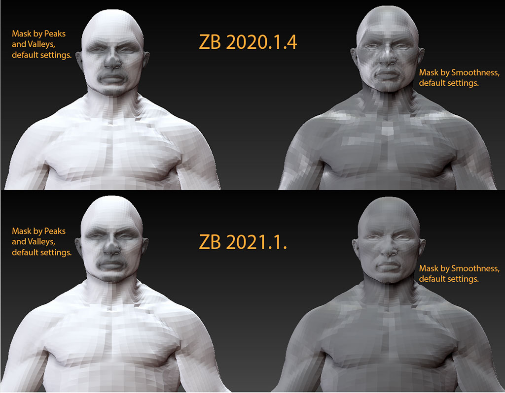

Here is the result of my testing into your issue. I used the same model, at the same level of subdivision, in both zb 2020 and zb 2021 at the default settings. The default settings have not changed as far as I can determine:
masktest
I can’t detect any difference in the results of Mask by Peaks and Valleys.
There is a discernible difference in the results of Mask by Smoothness.
This could be a bug. If you would like it to receive technical attention it must be reported to Pixologic Support. Reporting issues of this nature on the community boards will not place your issue in the hands of the developers.
Good luck!
